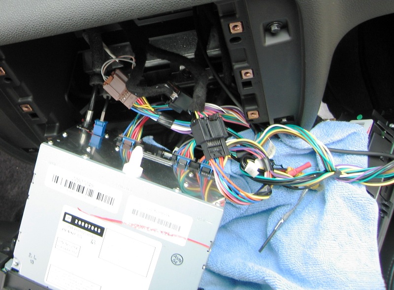

Well, it got here sooner than expected! I just installed it and so far it works great. Installation was fairly easy after I got the bezel removed. Which is actually kind of a pain. Had to mess w/ the jumpers a bit, but otherwise no issues. I did take a pic of the jumpers in case anybody w/ my setup needed to install one. I have the non-DVD playing Nav, has backup camera, and no RSE. I didn't bother wiring in the blue wire switch to manually enable to back-up camera since I really have no use for it. Neat feature though, may wire it up later if I add more cameras in the future (it supports 3 more).
I got it from eBay and it's branded as a "TVandNav2Go" GM Lockpick Pro GMX-322. It looks like the same one you can get from CostaleTech but it has a different sticker and it's about $115 cheaper. :smash:

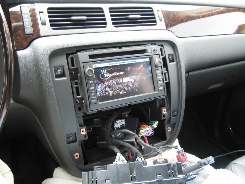

Video is from my Zune 120gb I just bought (specifically for the Lockpick). The pro-clip mount is on the way. It'll mount on the right side of the lower console.

Yeah, it wouldn't fit like it did in the Lockpick video's. I'm guesing the Onstar/BT module for the 09's is too big. But there is still enough room as you can see here.
And the final installation. Already got the pro-clip mount for my BB. Just waiting on the one for my Zune!
Thanks! Just got the pro-clip mount for the Zune installed. And I was bored so I took some more random pictures. :thumbs:
