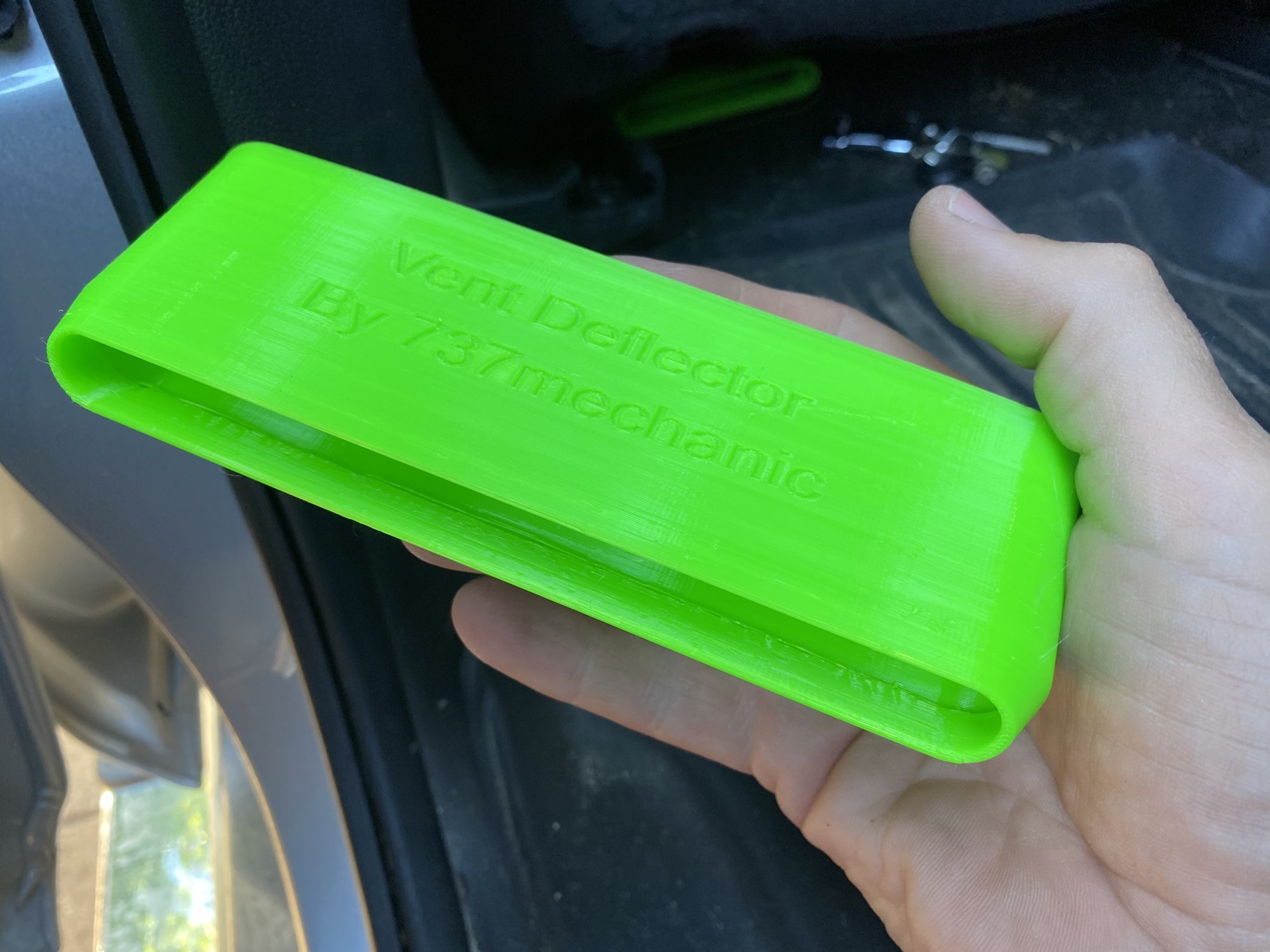

  4. No one will see them. They might be easier to notice if they get kicked out of place too.
  5. My nephew printed a set for me. Bright green was the color he had which is fine with me, they’ll never be seen. Thanks for making and sharing the print info!

  7. Do these need to be ABS or can they be made with the less toxic, more common filament?
