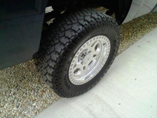

Thinking of buying some tires for the new truck before the hunting season. I really haven't raised the truck (Bilstein 5100's at the second notch up about 3/4" lift).
Was just thinking about getting either stock size 265-70/17 (31.7 dia x10.7 sec width) or preferably 285-70/17 (32.8 dia x 11.4 sec width, 9.1 tread width). It looks like there is just enough clearance for a 285-70. Anyone have any direct experience?

they will fit. There is a member that had them on his truck with stock rims and stock height with no issues and he used it offroad alot. I just can't think of his name at the moment. His truck is a gray GMC sierra crewcab and I think he is in canada.

Hey, you won't have any trouble putting a 285 tire on a stock GMT900 truck When I bought my truck I had 285's put on before it left the dealer and had no issues at all.

Only time it MIGHT rub is backing out of a tight driveway and turning full lock. Even that should be minimal (and worth it!).
Thanks guys. I'll go with the 285-70/17. For such a big looking openning in the fender, they sure are tight inside the well when turned. The Cepek FC II in a load range D look promising to me. About as aggressive a tread as I'm willing to go. I would almost buy another set of rims to just run them for the hunt season and put street tires back on the rest of the year, but sh%t a stack of truck tires is a pile I'm not looking forward to storing all year.
