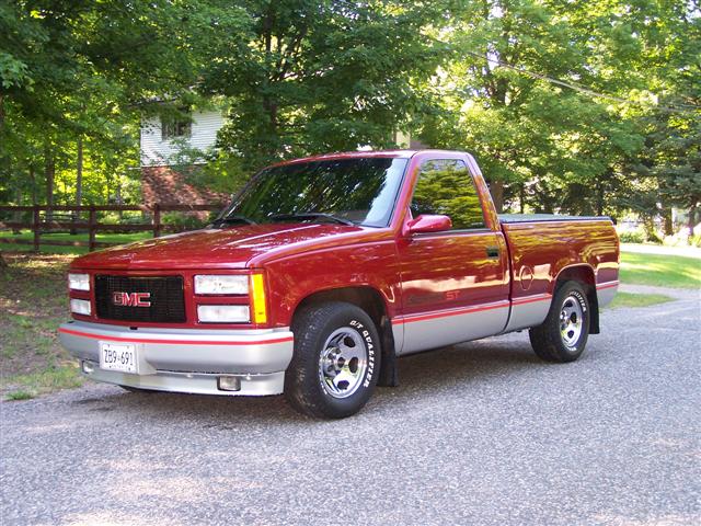

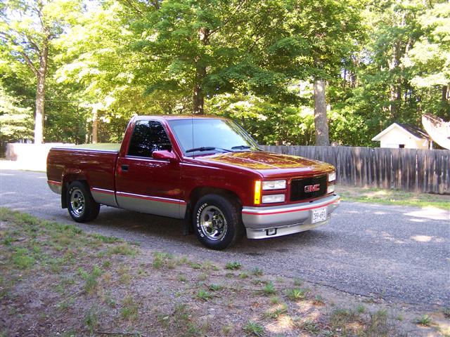

Thanks for the posts guys... I agree, if I could just bolt on the throttle body, then yes that would be great, but I don't believe it would give the right amount of fuel for the 350hp that the ZZ4 will produce. Here is a pic of my truck..
It's pretty much stock and original except for the front grill (wife hit a snowbank and broke the grill), 2" drop and Sir Michaels roll pan.
It's in real good shape and their is no rust on it any where, being from canada and all.
