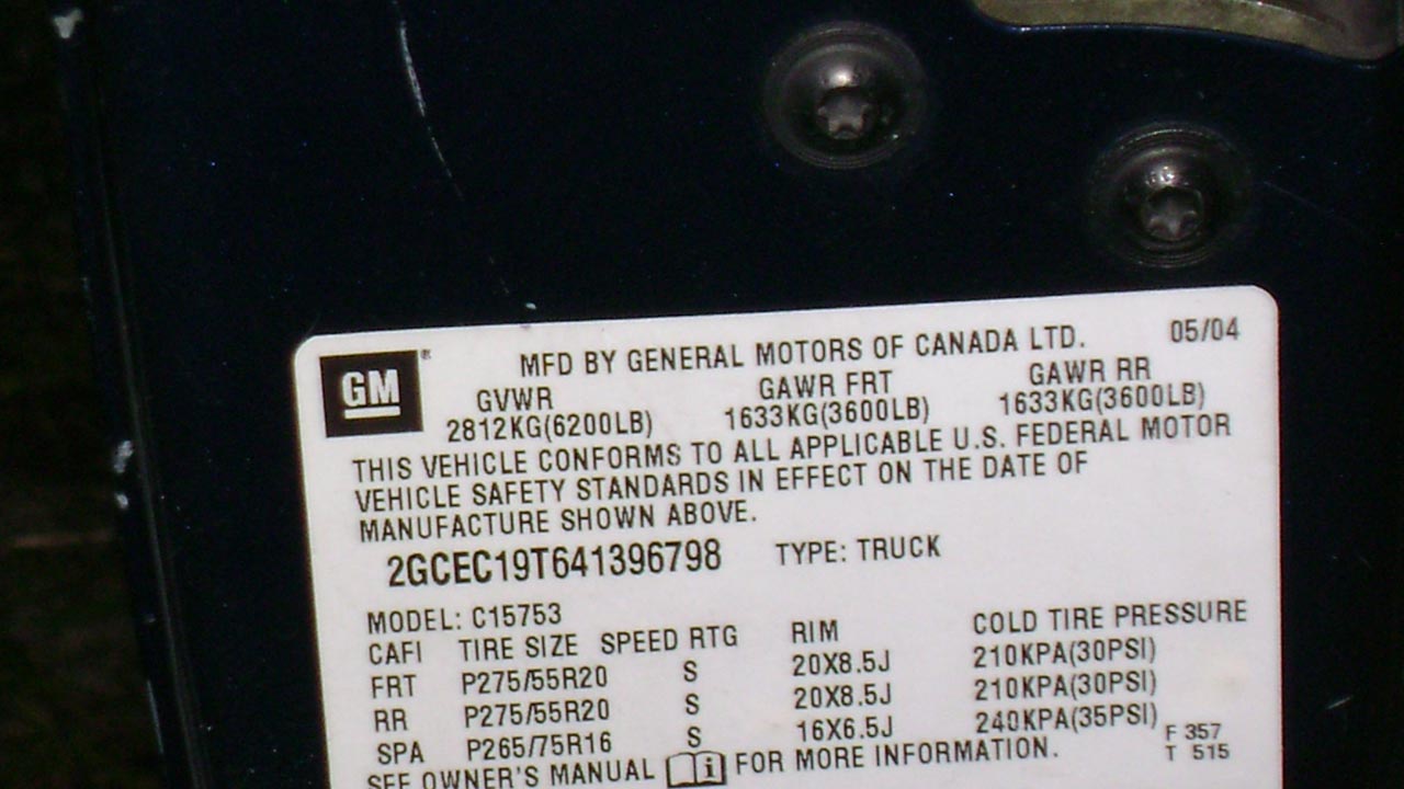

Off the path but did they even offer 20" wheels in 04?
Yes,.. they sure did.
Its part of the Z60 "High performance suspension package". (Thats how the RPO is listed)
20x8.5" wheels, 36mm front and 33mm rear stabilizer bars, mono tube shocks.
Its also the same exact RPO as the Silverado SS suspension. No AWD like the SS though,.. ( I wish ).
Front torsion bar suspension instead of coil springs.
Not the best looking wheels. But I think the ride with them is better than with the 16" or 17" wheels.
