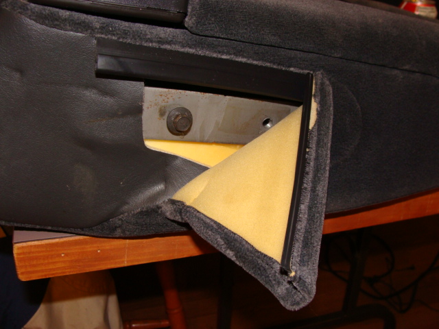

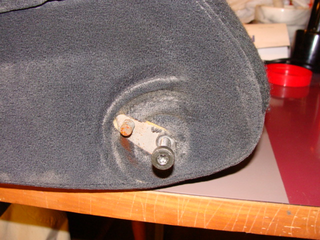

After a brief attempt to work on it in place I removed it and took it inside. There's one bolt on the drivers side and two bolts and a screw on the passenger side.

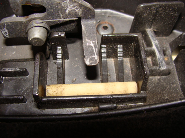

Then the trick is to get it open, which means getting the rod forward enough for the latch to work. If you look through the small gap below the latch you can just see the rod.
If you have a dental pick try to gently loosen it and tip the console until it moves forward and allows the latch to release.
Once the lid is open, to get to the latch assembly you need to remove the coin holder, this is held in place by four plastic latch/hooks. So the only way is to gently pry around the edge until it pops out. Mine had already been apart once and two of the receiver parts were broken.
So now its all open and hopefully you haven't broken much. ;)
So all that's left is to clean and reassemble. The plastic on my rod seems to be deteriorating with age and if it starts sticking again I'll be looking for some wood doweling to replace it.

get a high quality lock lube from a locksmith and spray the mechanism with it. A small amount of the lube goes a looooooong way. Had the same problem with mine and the lube worked wonders. Has not stuck closed since.

Thanks for the write-up and especially the pics. In fact, I joined this forum just for this thread. My time capsule . . . I mean, center console, has been sealed shut for years. I couldn't have fixed it without your pictures. I broke nothing, lubricated with a silicone stick lube and food grade silicone spray ( no petroleum distillates), and it works as good as ever. I didn't even have to remove it from the truck (a 2002 Avalanche with 151k on it). Thanks again - great post!

Thanks for the pictures - very helpful when the spring popped out when taking it apart and then to figure out where to put it back into.
I personally didn't bother putting the safety lock (white roller) back in - the odds on me accidentally opening it while up (since I don't use it as a seat) is way way less than the roller getting stuck again and going through this all over again. Sure works nice now though.

Thanks to member, "charge". It's sooooo much easier when you can work from photos. Mine is now fixed too.
