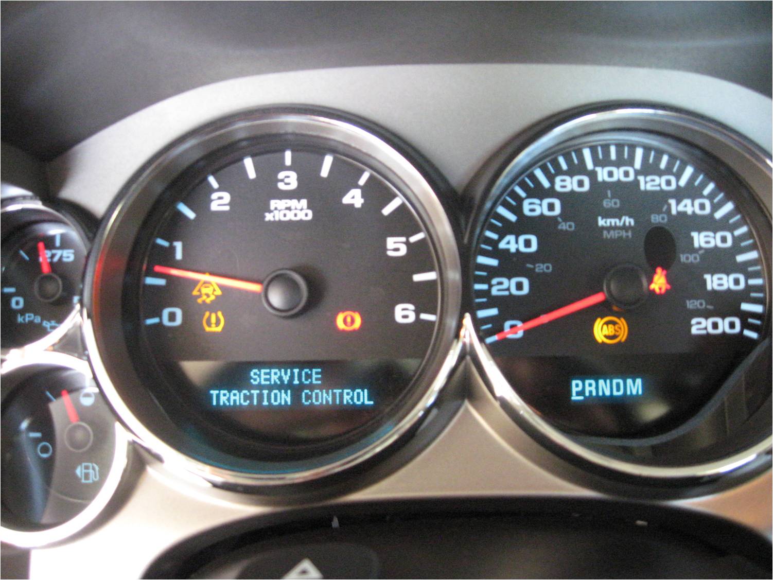

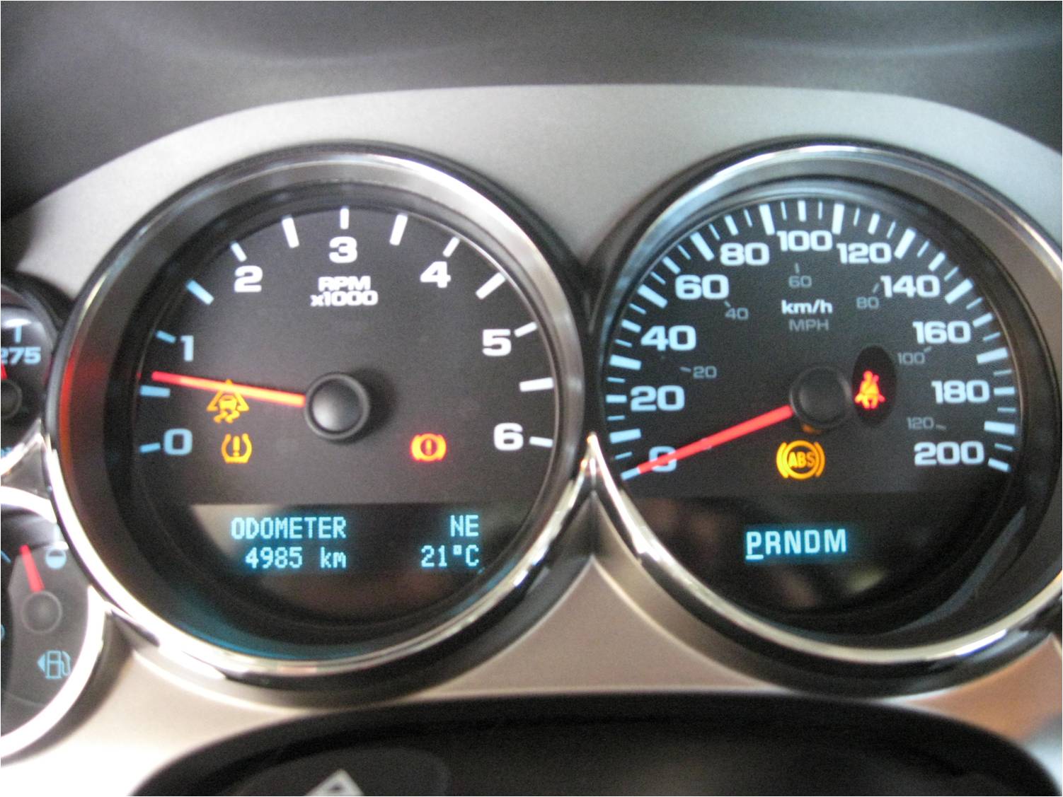

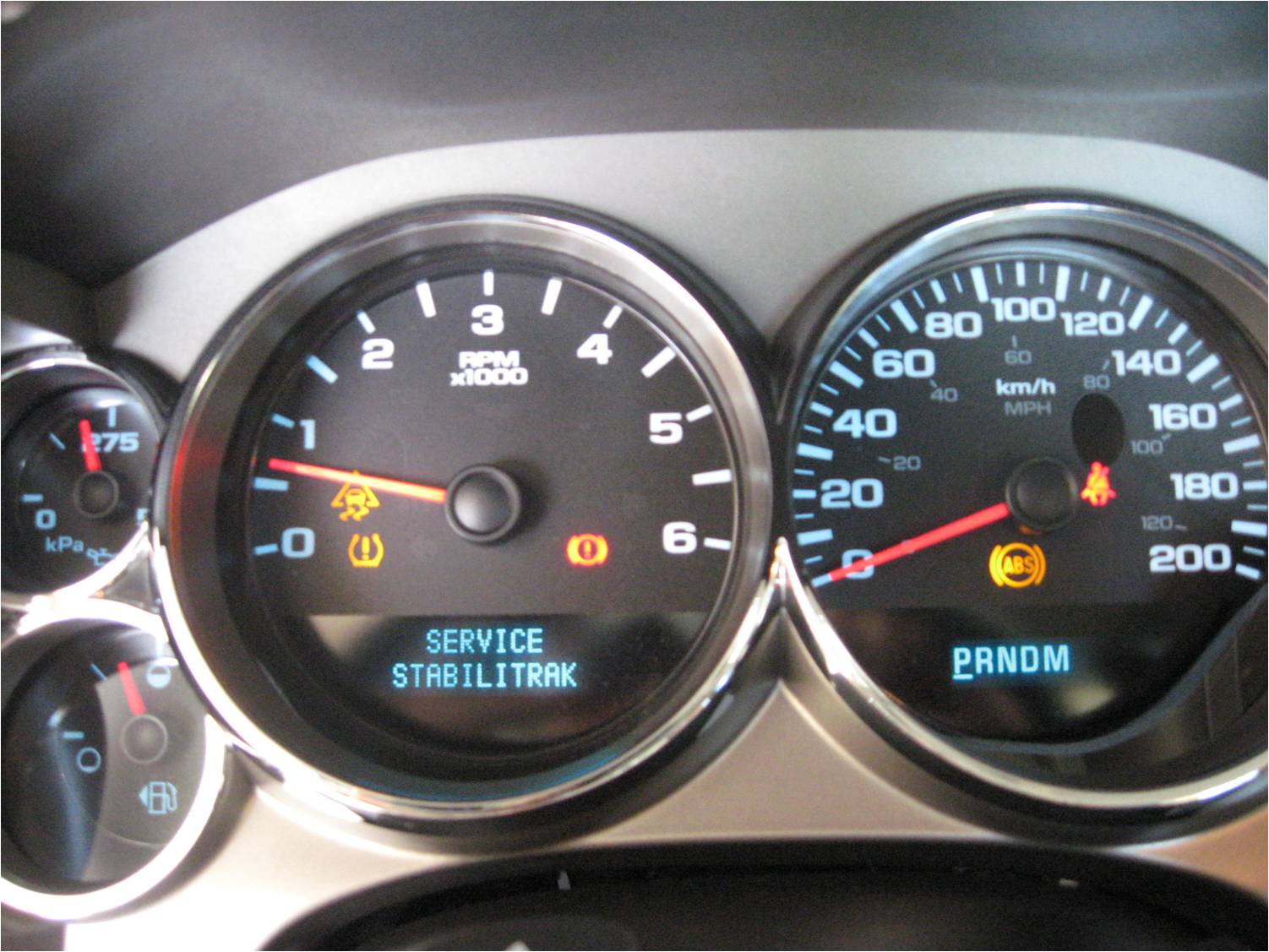

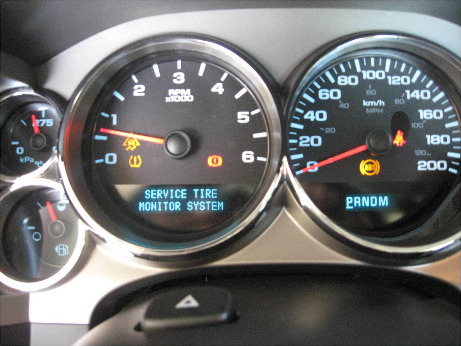

Guys,
My 2010 Silverado 1500 2WD shows multiple service messages.
SERVICE STABILITRACK, SERVICE TRACTION CONTROL, SERVICE TIRE MONITOR SYSTEM
Also are ON many warning lights
ABS, Traction Control, Tire Monitor System, Brakes
I already took it to the dealer for service 3 and I was told that they could not reprogram and would request support from GM. This week I took it to the dealer again and finally they order a replacement part.
PN 20817957 VALVE KIT-BRK PRESS MOD
Do any of you know if replacing this part will fix this issue?
Can you think of another cause?
I'm from Mexico, unfortunely the Customer Service in Mexico does not compare to that in the US. I'm getting some support but I'm still driving without these safety features.
Here are pictures of the cluster (currently 4900 km but failing since 100 km)
don't know what part they are changing
I don't know exactly how all of the systems work, but I would imagine that the ABS sensors provide feedback to Stabilitrack and to Traction Control, but I don't know what that would have to do with the TPMS, unless the sensor to pick up the signal is all one big integrated sensor... that's just a shot in the dark answer of the direction I would look at it... but with the dealer's TechII they should be able to tell what sensor/ module isn't responding I would imagine
I can assume you have non factory wheels and replacement
larger than stock tires????????
If you do........Thats the problem.
A PCM custom burn is the cure.

The part description sounds like brake pressure module, not TPMS. Probably something going on in the ABS module. If the dealer contacted GM, there's a chance they know what they are talking about.

The warning lights were on even with the OEM tires and wheels, I had already taken the truck to the dealer 2 times when I change them.
I did put the tire sensonr because I didn't wanted the light on all the time, but they told me that they couldn't program them, I'm guessing it has something to do with the rest of the warning lights.
I happen to be by the border and I did call a dealre but they told me that they couldn't take care of my truck, but you make a good point, if I tell them that it just happened they should take care of it.
The service department should always start with the lowest code # first and repair that before going to the next. Give us the codes so we can see them.
