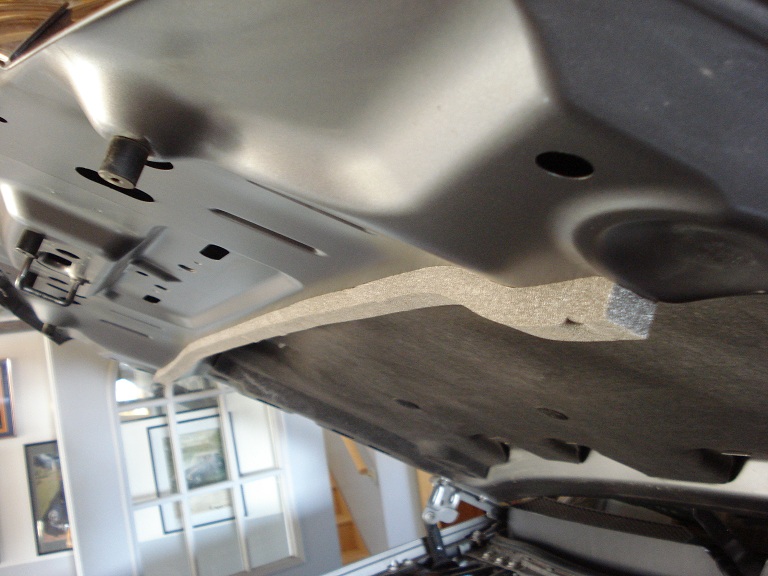

I changed the oil and filter, and greased the tierod ends today, and wasn't very happy when I saw the crap that blows all over all that black plastic stuff under the hood. There's abig gap that lets dirty water just blow in onto everything. Anybody else have this problem? Thinking about a deflector or gasket to make it stop. Never had this issue with any other vehicle, car or truck! (GMT900)
Here's the fix. I used expanding gasket (1 inch) for steel roofing from a lumber yard. So far, it's great, but I haven't driven in real crud since the install.
