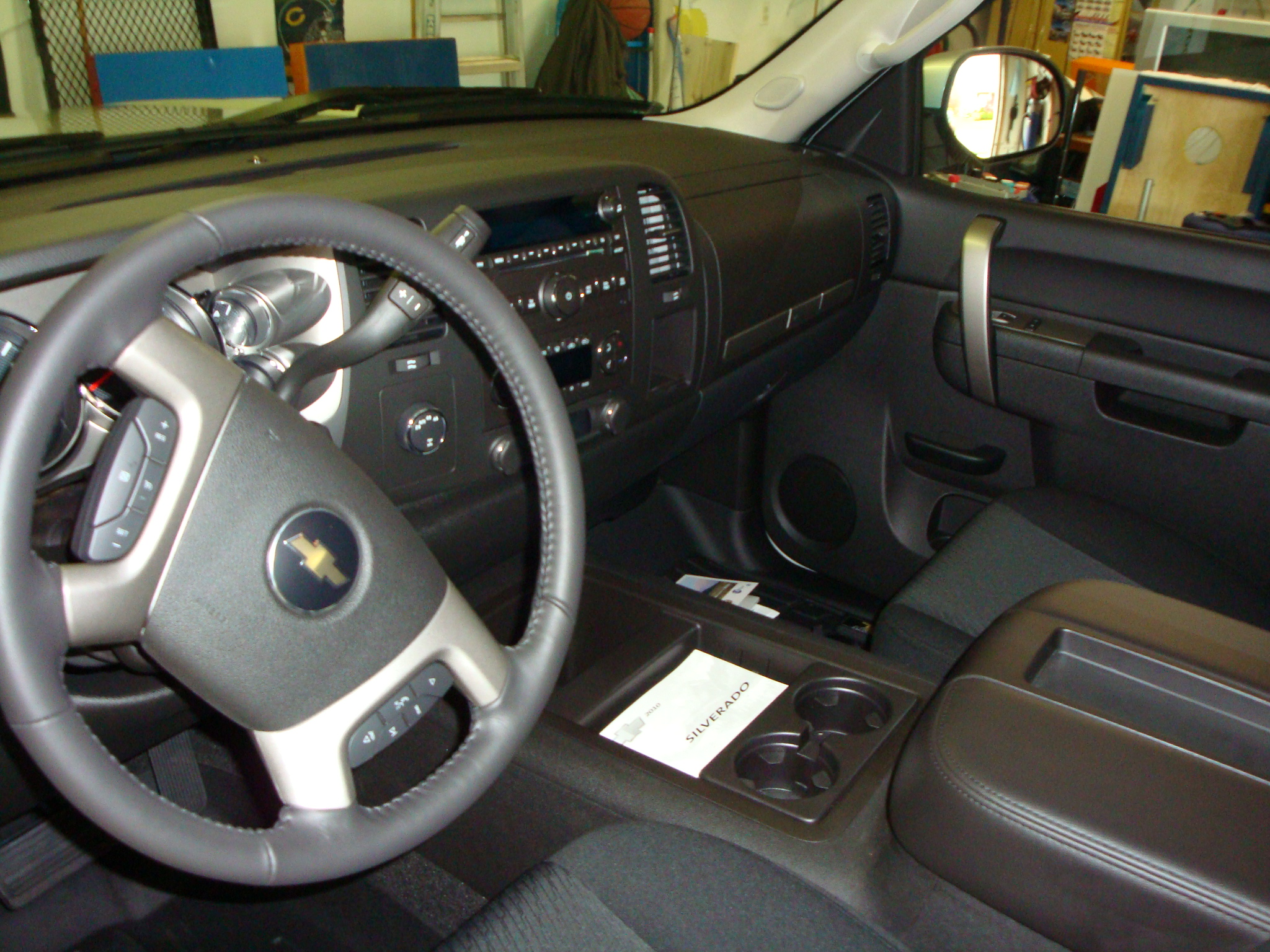

Here is the silver in my 2010 (std LT trim)
part numbers are on page 1 of this topic
The part numbers on the first page don't come up as being silver on gmpartsdirect.com. It just says steering wheel module.
