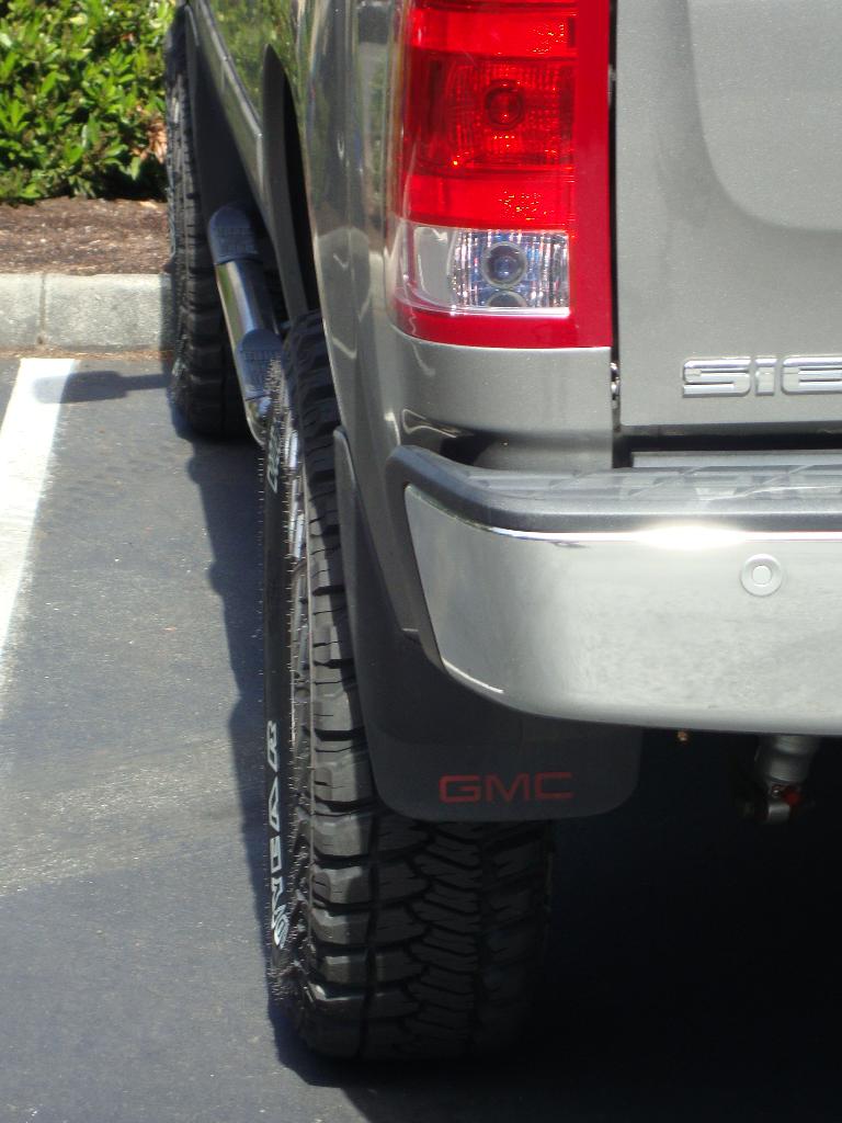

I installed the '' Chevrolet Truck/SUV - H&R Wheel Spacers - PN80106781'' - 40mm
http://www.livermoreperformance.com/gm_wheel_spacers.html
These do not require cutting of the OEM Lug Studs, the spacers being 40mm and the OEM studs being appox 45mm the OEM Stud rests in recess within the OEM Wheel
Depending on the OD of the 19MM Socket you have - you may have issues - a very tight fit - used lubricant to install nuts and so Socket would not Jam in Spacer Clearance hole
the Studs on the Spacer are approx 10 mm longer than the OEM - the Black Lug Nut Covers still do fit
in his sig it says the front is 3" wider than the rear so he added this to the rear of the truck to have an even stance.
Well I see that now but they don't come stock with that much difference... just wondering what's up. Maybe he has aftermarket front spindles? I'm not sure what the Rancho comes with.
Like you, I'd like to see some before and after pics.
