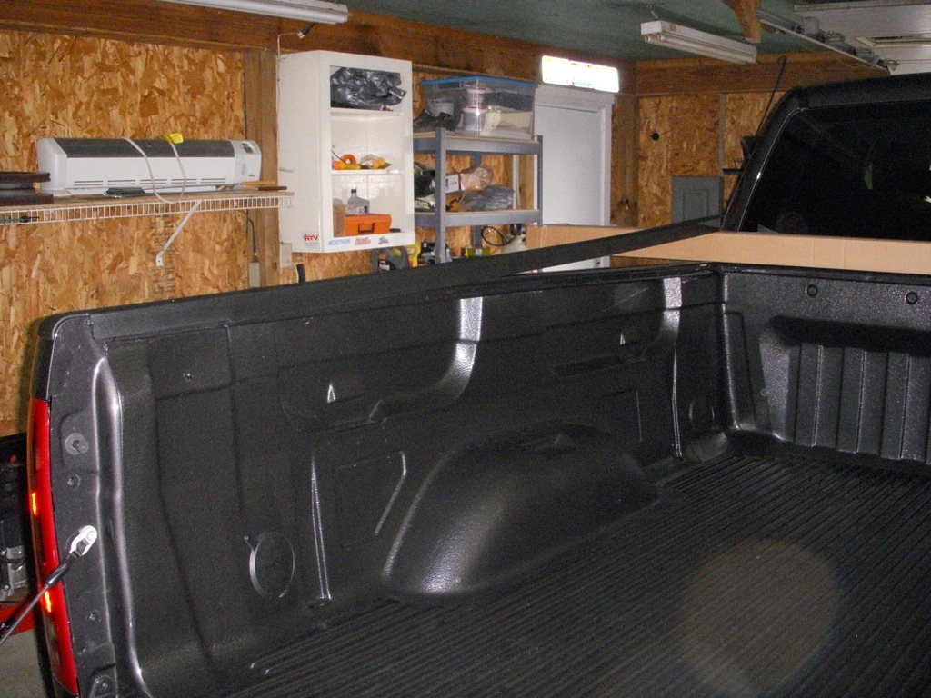

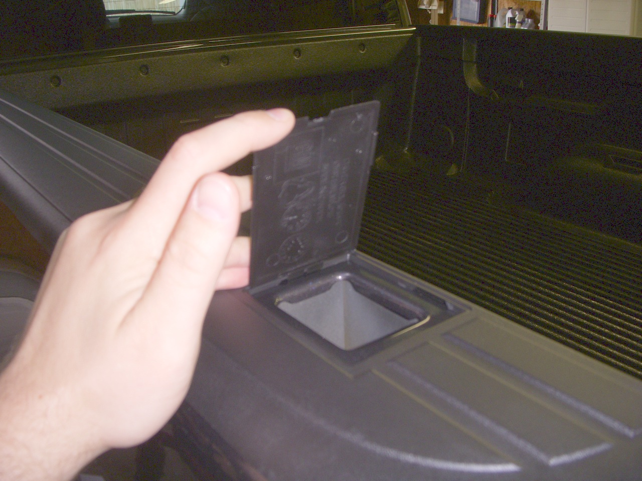

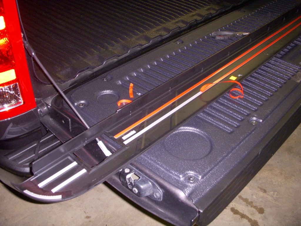

Just Thought I would Give a quick run down on installing bed rail caps. Its not hard I just wanted to be helpful to anyone that had questions.
Here is a picture of the bedrail caps
After pulling the backside of the tape off I placed the box that the rail covers came behind the cab on the bed. This allowed me to start down at the
end of the truck slowly lining up and pushing down working my way back to the cab of the truck.
Nice job!! Pretty much how I did mine but when I was working toward the front, I kept some pressure towards the outside of the bed on the inside of the cap. Hope that makes sense.
They run arund 109 + tax but I got 10 percent off since i just bought my truck from the same place a month ago so I spent 104 out the door. Im very happy with how it turned out. :) Now I am trying to figure out what I would like to do next.
