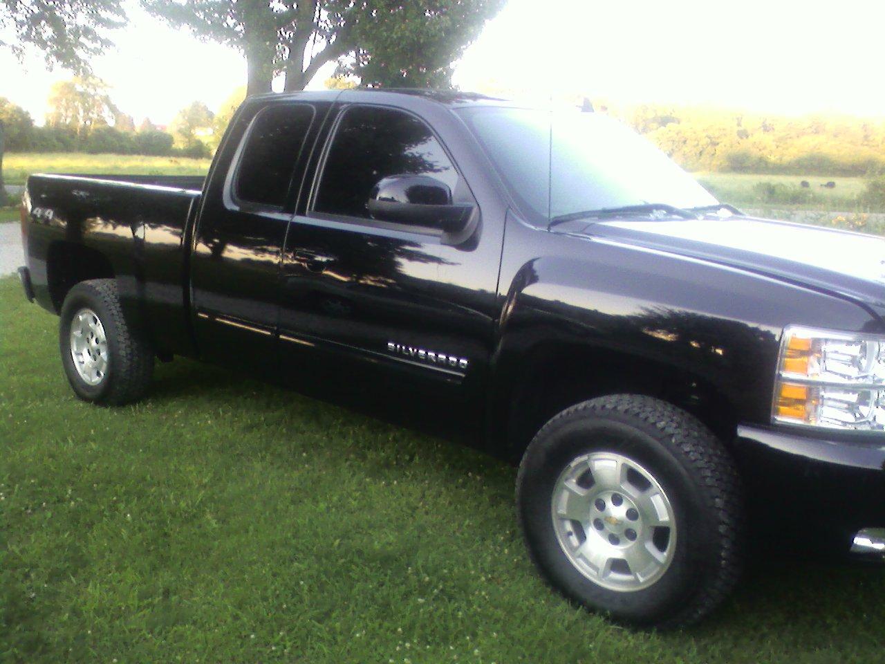

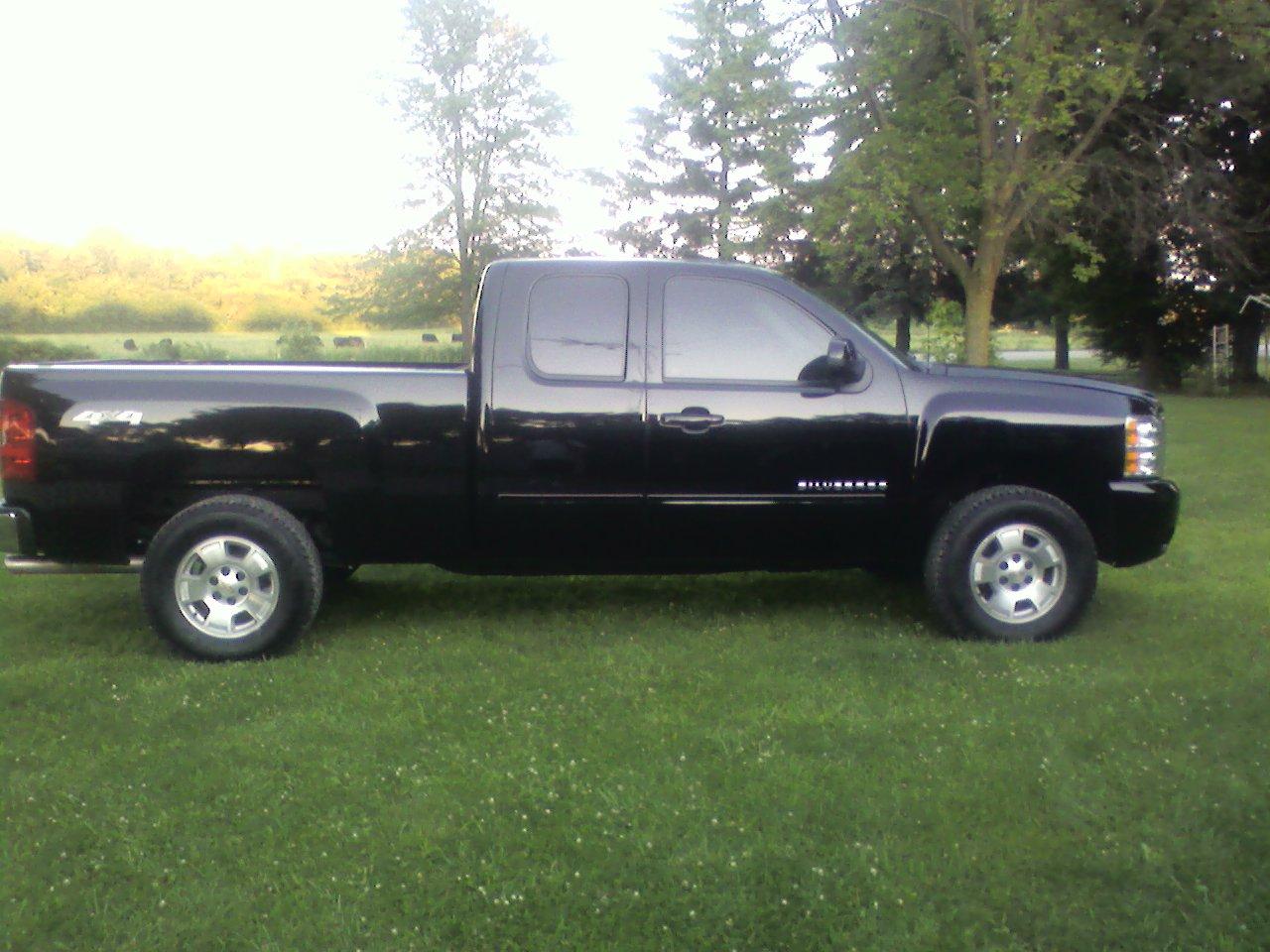

1.5 In The Front
Looks good to me,Thats what I have on mine,But like Matt said...Its a little hard to tell with the uneven driveway.
38 front and 39 1/4 rear, wheel well center of wheels
Wow there's still 1.25" difference... So you had about 2.75" rake stock?
My truck has exactly 2" rake from the factory.
I'd leave it the way it is if i were you. Looks good :)
Yup, looks great the way it is now. I have a 1.5" lift on the front of mine too. Difference is I only have about 1/2" of rake after the lift :)
It wasnt a kit, it was two pieces of 1/2 plate steel cut to match parts from a kit a guy at work bought. I dont know what kit it was though. I jacked up my truck, removed my wheel, removed the two bolts from the bottom of the strut and added this shim we made. Fast and simple install. Its the best I can do with the paint program on my pc, lol
