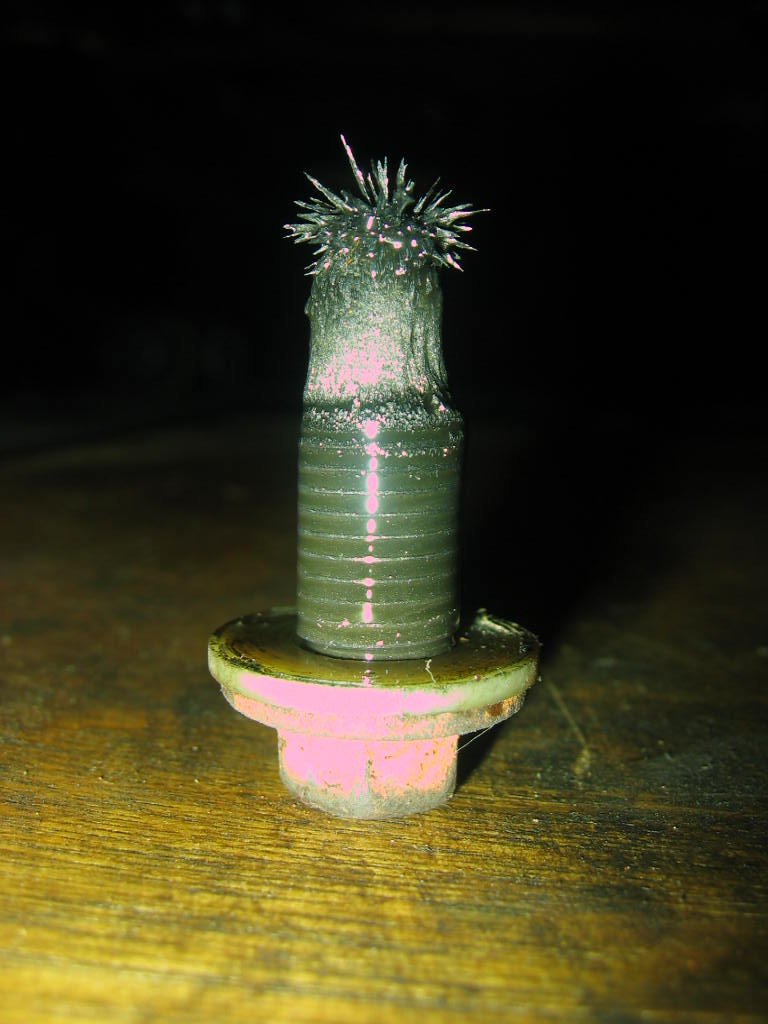

I asked a shop to drain the front diff when they serviced my tranny and transfer case at 100k miles. After inspecting today, it was clear they didn't so I drained the gear oil tonight. Attached is a pick of the drain plug, which I will forever refer to as "chia plug." So much for the lifetime fluid reco from GM.

That's nothing uncommon....
This is exactly why I change mine out at 2500 miles and monitor it from there. All the crap from initial break-in makes a real mess, and also makes it hard to tell if you have ongoing wear problems after the parts are all worn in.

I changed plugs at 90K and they came out with no problem. I also use oil analysis from Blackstone labs to determine change intervals vs. guessing. The truck shifts like new and runs great. I run 10k mile engine oil change intervals with 135k on the odometer after lab analysis showed plenty of life in my full synthetic with no metal contamination. The only thing I would do differently is a break in change on the gear oil at 30k to remove gear shavings.

Did my front and rear diff last week at 125k, plug in front looked just like yours, the diff lube was a dark amber color. Pulled the rear cover to find 2 qts of a stinky black as coal substance that used to be gear oil and a glob of metallic snot stuck to the magnet. Guess thats pretty normal though. At 100k If you want to see more crappy lookin fluid check out your power steering.
