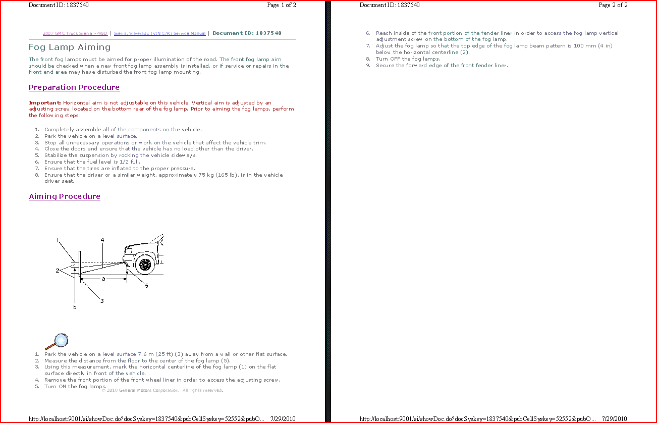

Hey guys, just wondering about aiming my new lights, I'm putting in my fog light kit tomorow. The kit says to refer to Fog Lamp Aiming Document ID#1688536
I know in a previous thread someone made mention that there is no side to side adjustment and to max out pointing them up. Just want some clarification on this because I don't want to look like an **** to oncoming traffic. :fume:

I found a building in a dark area of a parking lot and pointed the truck at the building wall about 30 ft away
turned off the headlights and turned on the fog lights
adjusted them up until they were even
pretty simple. but I do wish there was a side adjustment too

pretty simple. but I do wish there was a side adjustment too (and IMHO there needs to be more vertical adjustment)
I have attached the fog lamp aiming guide.
