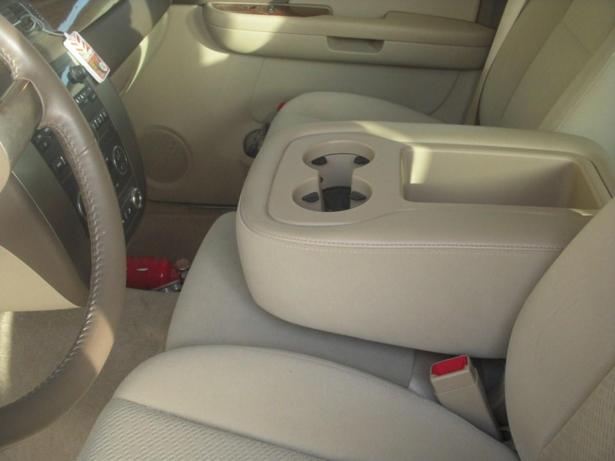

Now down to the questions, if I may. I love the car but after a couple of months driving it, the only complaint I have is lack of storage space at the side of the driver due to the seat in the middle, as can be seen below. The seat seems a total waste of space and I would prefer some sort of console. It wasn't something I even thought about when buying it. Is this seat easy enough to get out and what options do I have to put in it's place. I.E. will a console from another Yukon i.e. Denali or from a Tahoe fit easily in it's place?

Hey Barry, welcome and congrats on the ride. As for the console you can replace it with a console from another Yukon. There are several different styles so be sure you pick the right one. You can usually find the on eBay anywhere from 200-500 on avg.

Should be able to use one from a Tahoe/Yukon
Here is a photo of the stock one from my 08 Tahoe
Thanks Ryan. Do you know how I can get hold of a stock number/part number?
Many thanks Geoffrey. I will look into it. It now gives me hope. :lol:
No problem Barry, I did this same swap in my 09 when I had it. Only difference was I had a Silverado. I was ver happy with the results. Not to mention it will look a lot better with a full console in the Yukon / Tahoe with the way the dash is laid out. Good luck w/ the swap!
