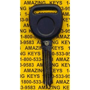

This is a transponder key. Note the circle with the cross on the shank.
These guys have the correct transponder key for the gmt-900s and less than $20 bucks:
https://www.ikeyless.com/vehicles/Chevrolet/Silverado/2010
You can buy the key and have your local hardware store cut it for you off one of your spare keys.
You can also program it yourself
(if you have another original spare key).
Insert original key....Turn to run position (do not start)
Wait for security lights to go off. Turn ignition off.
Insert new key and turn to run position.
DONE!
NOTE: If you lost all your ignition keys your screwed and its
time for the tow truck and a trip to your local GM dealer and
a $pendy date with the Tech 2....................
