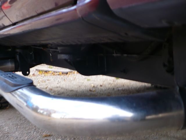

i think rust proofing definitely works i would like to get mine completely rustproofed. but for mean time i just get rubberized rust paint and paint the high rust areas. painting the wheel wells definitely looks better.post-74677-1286243438_thumb.jpg
