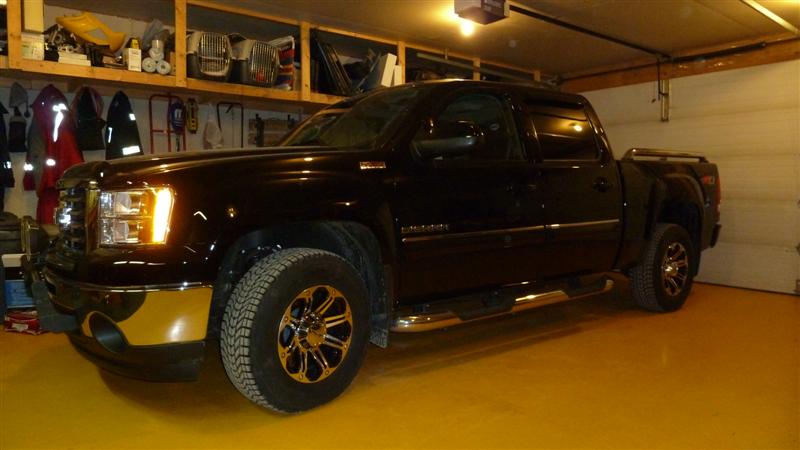

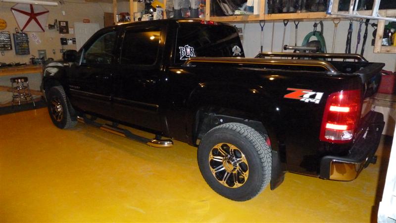

Those wheels almost look too nice for snows. I've used the Winterforce tires in the past. A little noisy (especially with studs) but I went never had to wait for a plow or a tow. Now using Blizzack DM-V1 - same capabilities with a quiet and smooth ride (they don't tear up my driveway) but they're much more expensive.
