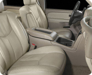

I am not for sure on this, but everything I have read is saying if you have the GMT 800 trucks with the two bucket front seats and the center console and the bose system then there is a sub in the center console. I'm not sure on a suburban though. I would think it would if it was the same setup. Most people that have one didn't even know it because it is so weak. But if you know where to look, you can certainly feel a little extra thump there. If yours looks like this pic, you should have a small sub just in front of that cupholder.

My 2004 Suburban has the Bose system and the subwoofer is in the center console. The output is not weak, either. If I turn the bass all the way up on the audio controls, I can feel it in the console and the floor. It's a much better location for the sub than all the way back in the storage area, like my 2000 Suburban had.
Yeah I can certainly tell it's in mine also if I crank the bass all the way. I just hate to do that because it's then putting out so much bass in the speakers that if I crank the volume way up I think it's stressing them. I get some raddling and stuff. But don't get me wrong I love the bose sound system. It's sounds great. I would just like to be able to set my bass eq at balanced and add some extra bass. Then I'd be able to get some clean LOUD volume with good thumping bass :uhoh:
