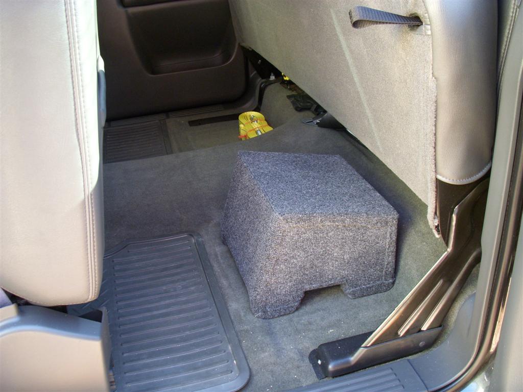

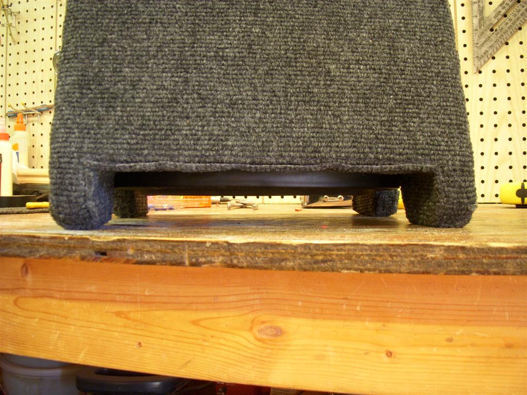

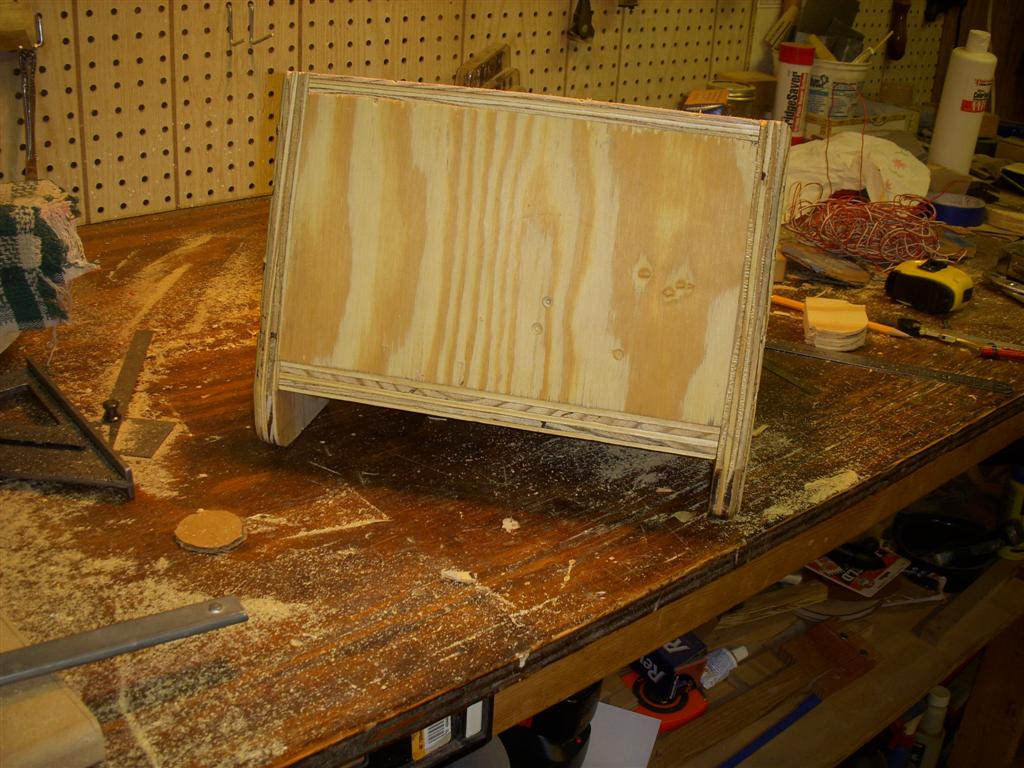

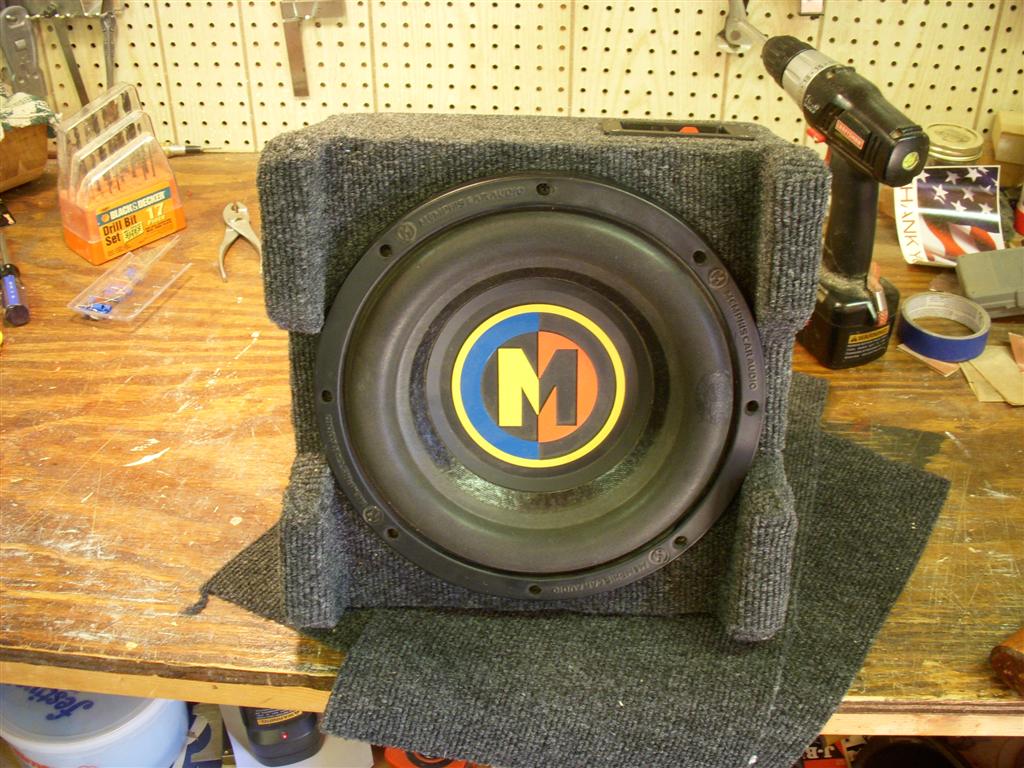

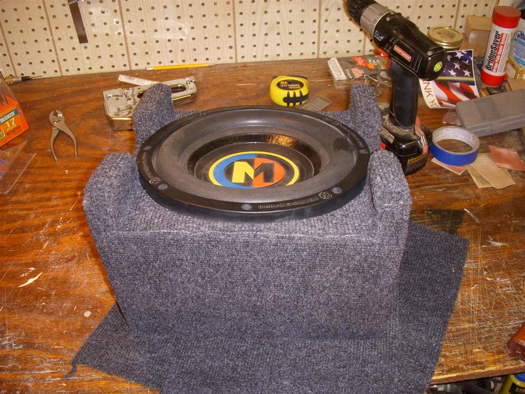

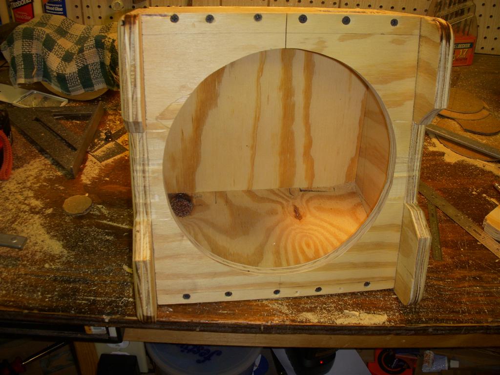

I just got through building one that goes under the back seat in my truck. It holds one 10" speaker. I made it down firing. So the sub speaker faces down. It is a tight fit height wise. It barely does fit. If you made the speaker facing out it would be no problem. I can post pics and dimensions if you want?

This kinda slipped my mind...I did remember to take pics though. I'll just have to go out and take the measurements tomorrow. I'm not for sure if your truck seat is the same or not...you can measure your seat space and see if it will fit. My speaker depth was 5.5" I think if I remember right. If your 12" has more depth than that you may need to go with a traditional, one that is not downfiring. Because it was a very tight fit for mine in depth. I also built one for my brothers '94 ext. cab. His actually had more clearance under the seat. I had to make mine smaller for my '04. One thing to point out is that you don't have to cut the notches out on the bottom sides. I just did that to see if it would let more of the sound waves out. Most of them will be straight across on the sides. You could also make it to where it is a lot longer and fits up onto the hump in the middle of your floor. I just didn't care for all that. Just wanted something simple to hold my sub speakers. You could make two that are identical for both sides.
