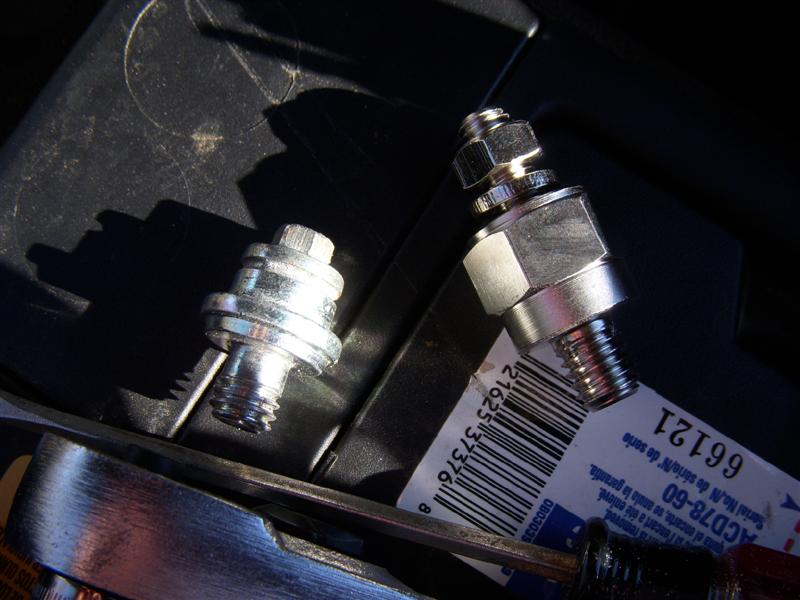

They sell a special bolt at auto parts places that you can use. It replaces the factory bolt. There is a smaller bolt that bolts into the large bolt. You use the smaller bolt to wire up accesories with ring terminals. They are usually brass and are gold in color. This one is silver. Click here

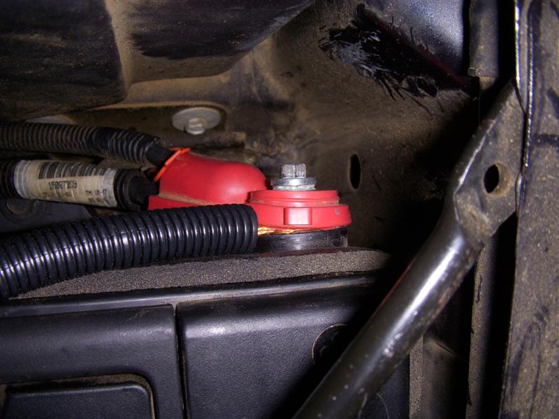

Yeah, there is a ridge around the rubber that fits into a groove on the battery it is made to seal up tight. There is no way to put a "0" ring under it. Even with a longer bolt The rubber seal is not going to allow the teminal to seat right with an "0" ring under it. You could just put the wire against the batter terminal, sandwich it in. Or you can buy the adapter which is what I would recommend. I happen to have some pics handy from when I installed and amp on my truck.
yes! thank you colby!, this is the first time ive ever wired something up on this truck, my last two cars have had the battery terminals on the top, which made it easy. but thanks guys, i didnt know they made an adapter for it. i will go to advanced auto parts tomorrow and see if they sell it!
thank you, good to know about this battery terminal adapter
