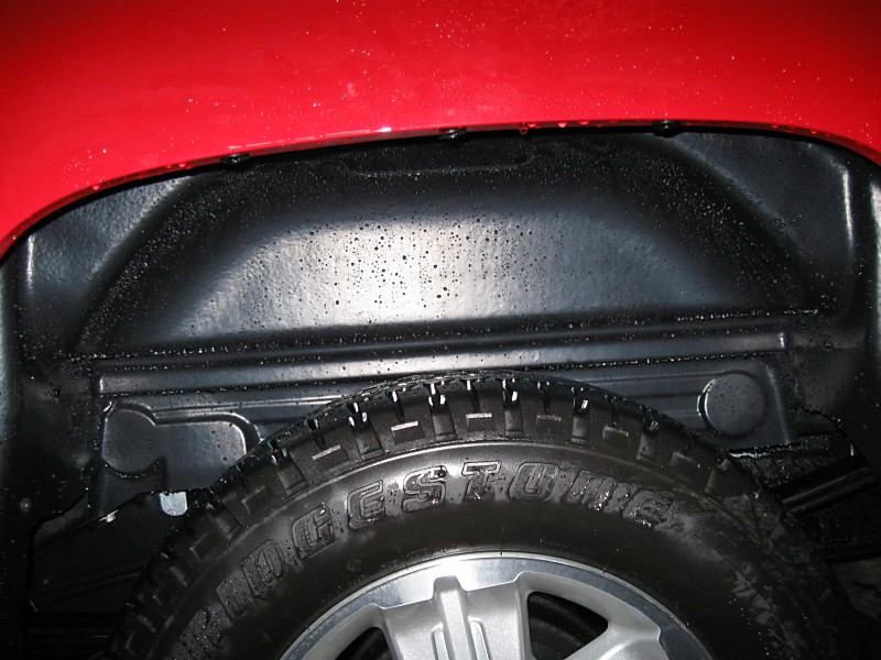

Just did this today they look great.
I used some 3m aerosol bedliner. real easy to do, I would recommend it. Looks good. As you can see in my pics, I got too close when I first started and ended up with a small run, but unless you look for it it's un-noticeable and pretty cheap. clean em up with degreaser and scuff em up with some sandpaper and spray away. Don't forget to tape them off first.
I have the plastic liners too. Only thing I am worried about is the small rocks, dirt, etc that collects at the lower leading and trailing edges of the liner next to the opening for the wheel wells (there is a small pocket there). Stuff collects there on mine. I do not really see how it can be prevented. The truck has also been undercoated. I offered to take the liners out for the undercoating appliers but they said it wasn't needed. Wish I had.
I like both options... the liners due them covering up the gap... and the spray due to thats less $$'s :rolleyes: I'm off this next week so I will have sometime to get it done...
the liners on mine don't cover the frame, stops just at the top of it. Has GM changed them recently ( purchased my 2011 about 3 - 4 weeks ago)? Mine came included in a package.
How do the GM Liners install? I guess are they a drill or no drill?
They come with self tapping screws that are used to hold them in place, but most people don't use them at all. The liners are a tight fit, and pretty much "snap into place". You shouldn't even have to remove the wheels/tires to get them in place...at least I didn't and have read of more people that didn't also.
