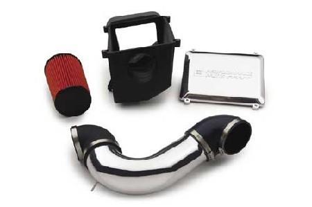

try the gm performance cold air intake..the filter does not require oiling and it won't void the factory warranty..had one on my 07 avalanche before selling it..loved it!

The GMPP model will fit the 6.2l engine. Unfortunately, the 2009 - Present model trucks require a different part number than the ones prior, due to the change in design on the Mass Air Flow sensor. GM decided to discontinue the one for the newer model for some reason, and all existing supplies seem to have been depleted.
I was lucky enough to find one for mine, but I think I got one of the last 10 or 15 that were available, and the rest went very quickly once the few remaining were discovered.
With all of that said, the only benefit I have seen was appearance, which is why I bought it in the first place.

700sportsman is correct on the fitment and ebay..however f.y.i. the gm cold air intake off my 07 avalanche did not fit my 2002 sierra although they had the same 5.3 engine..(fan shroud was in the way and too short)..there are two kinds of gm intakes..check with ur dealer for the correct part number and look on ebay..the one that fits my sierra had a longer chrome tube.(see my intake photo).from my experience with the intake i lost 1-2 mpg.but it did breath better and the motor accelerated with less effort..imo..next time u get tires..find a low rolling resistance tire(michilin ltx m/s2) to equal out the mpgs..
