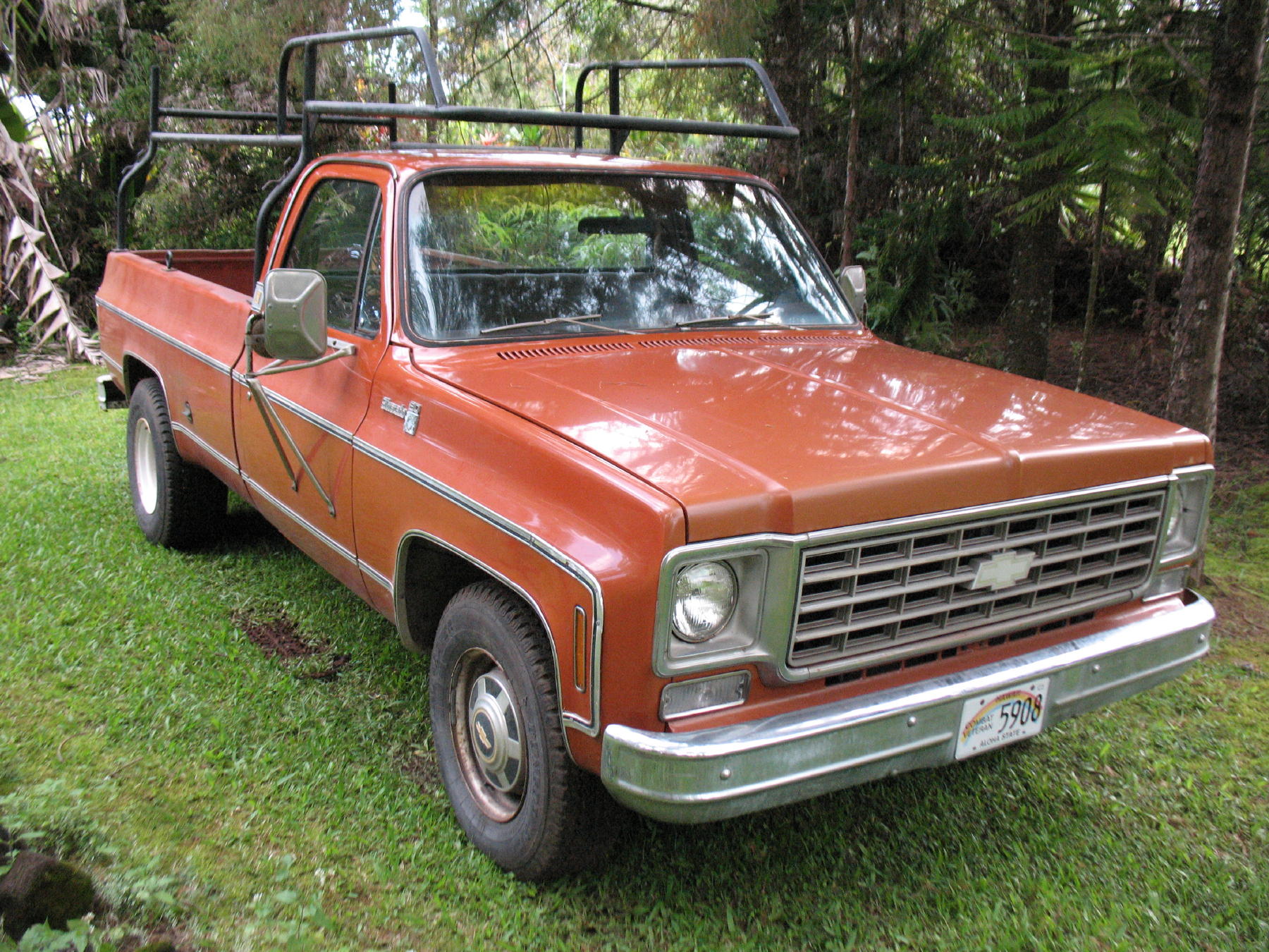

My '76 Camper Special has dual saddle tanks. I never played with the switch on the dash until a couple days ago. It had always been set on the left tank and everything was going fine. Then I started switching it back a forth. I returned it to the left tank before parking it. Yesterday I got about a quarter mile down the road and it sputtered and died. I thought it was dirty fuel from that right tank since the truck sat for a couple years. Gas gauge says 1/2 full on left tank. Right tank said nearly empty. My wife towed me home in our Toy truck (embarrassing) and this AM I put two gallons of fuel in my right tank and primed the carburetor. She fired up and ran after a couple of primes. Now I know I ran out of fuel in the right tank but the selector switch is on the left tank.
Please, any one with experience on these things tell me what might be the problem. I can here it click down on the frame somewhere when I switch from one tank to the other but haven't crawled under until I can get help with someone in the cab switching.

I've replaced front brake calipers and pads, changed out the trans fluid and found one leak there as well as added some Lucas Trans Leak Stop. Changed brake hoses, fixed the lights that didn't work and hopefully will get this taken care of. It has an exhaust leak that isn't too bad and I think I'll put a patch on it.
Fun old truck to mess with but the gas mileage is a killer. $3.70 for regular here now.
