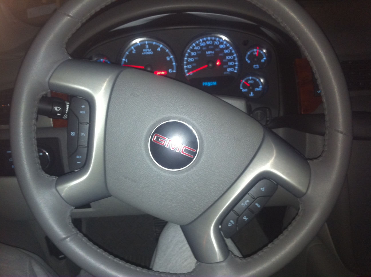

yes its off. This is how it looks when I am heading straight
The reason behind his suggestion is the rod indicated in the previous pic is on its maximum position and he needs to move it beyond that point. Now the tires are shaped as \ /.
I think this will wear my tire unevenly, reducing the life of the tires.
Something in the suspension is incorrectly installed or your wheel alignment tech is not capable of setting front toe correctly. The steering wheel off, and wheel alignment off, will cause this stability system issue.

Currently the steering wheel is waaaay of and its really annoying and I'm not planning to replace the tires every now and then due to uneven wear !
The tires might wear ok with the wheel crooked but the stability control, and traction control is trying to figure out why the steering wheel is always turned. Be glad the lights come on. This disables the systems. It could be trying to keep you from running of the road when your not.
