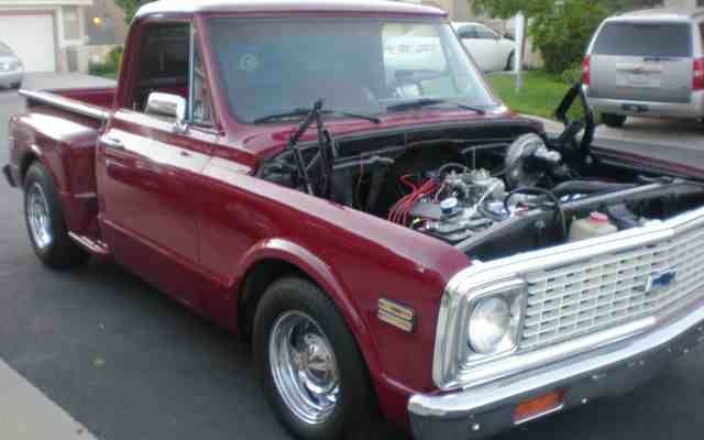

Just put in my new 383. The engine seems to run great. However when i put it in gear I can feel a vibration that gets worse as rpms increase. It does not do it in park/neutral. So it shouldnt be the engine. The truck didnt do it before the build so it has to be something I did during the rebuild.
where should i look? the vibration is not in the steering wheel and not when i brake. oh the trans is t350. thanks!

first of all, truck looks great, id like a vid of it running/ taking off too, but thats neither here nor there.
