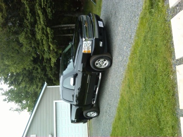

1st pic is when I first brought her home this summer.

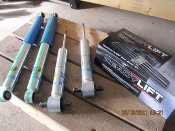

2nd is yesterday before install

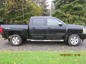

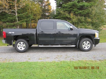

3rd is today after install. Sorry she's so dirty, I live on a gravel road and it's pissing out today.
