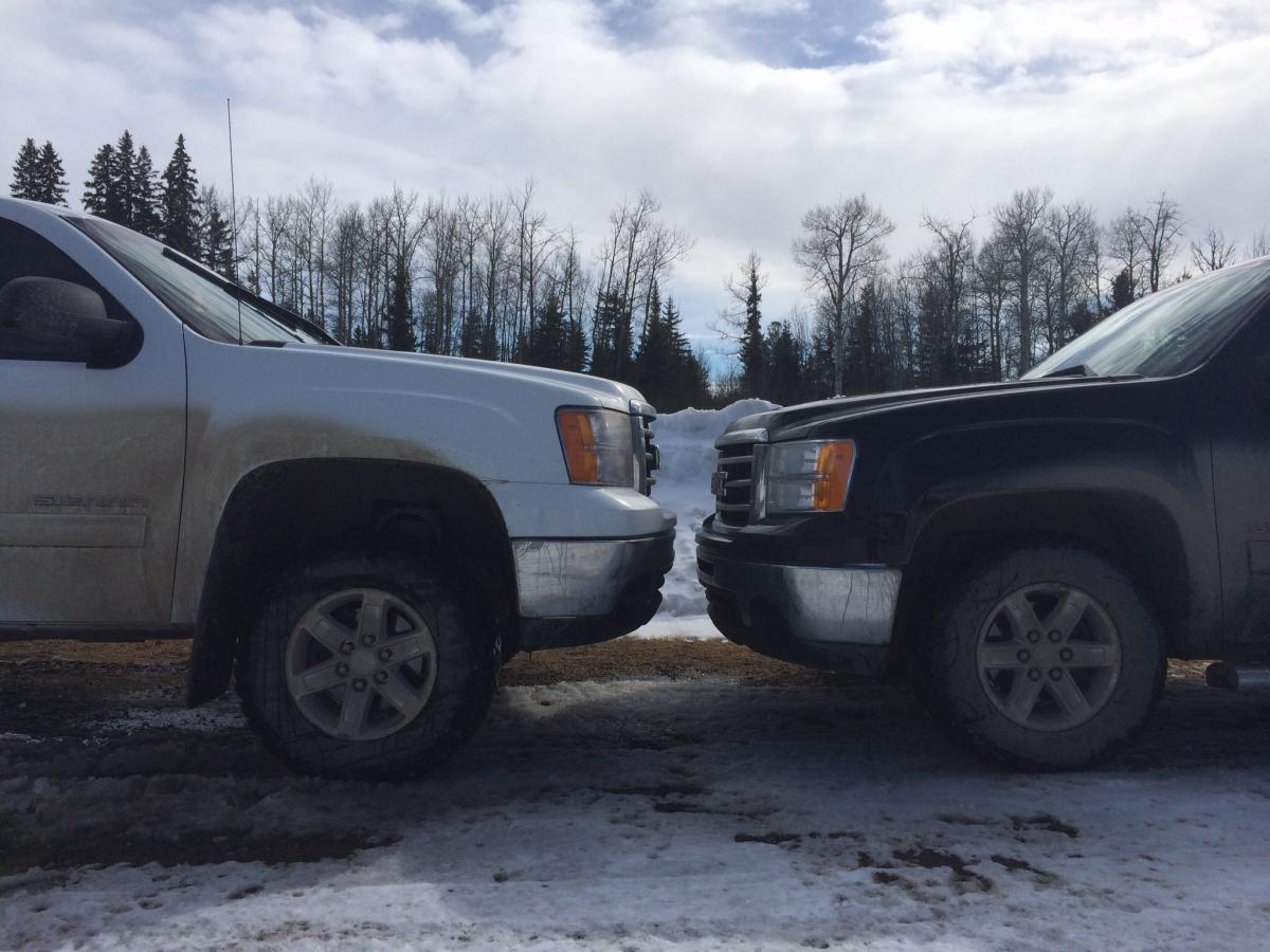

I put a 3 1/2" leveling kit in my sierra 1500 and 2" blocks in the rear and it ended up giving me 4" in the front and 2" in the rear and the truck sits bang on level and had identical truck to compare with at that time and took em both for drives on rough backroads and on washboard and then on the highway and was still same comfy ride like always in these gm trucks so i was very pleased to not have to sacrifice that and trucks sitting side by side it sure gives iit a mean look compared to the stock truck and made it start looking like a real truck instead of a city wagonpost-129717-0-29401300-1396922447_thumb.jpgpost-129717-0-51297900-1396922390_thumb.jpgpost-129717-0-82228000-1396922511_thumb.jpg
Wow, you can say good bye to your ball joints and CV joints with that much of a leveling kit, your CV axles have to be at a real steep angle. You can really see the top of your front tire leaning in as I said your front end is not going to last long.
That thing has to be riding on the droop stops. I'm loling at you saying it rides great.
