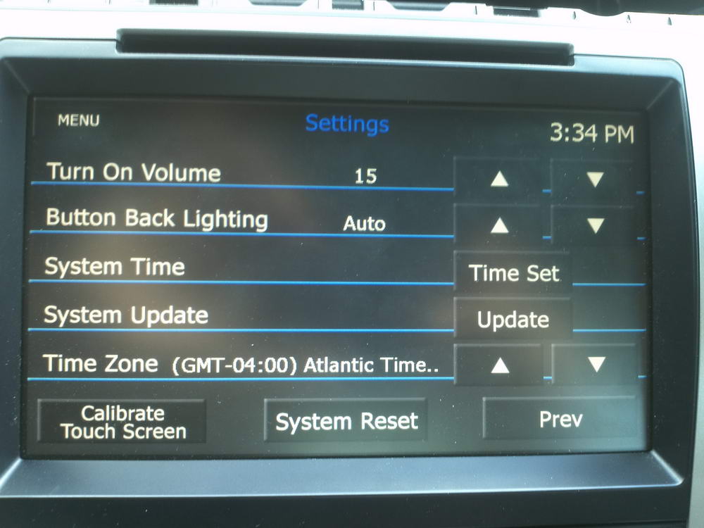

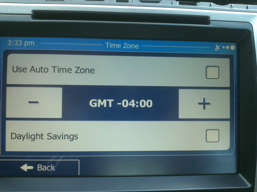

OK, guys - here's the response from Advent:
Walt
Here is what we found, there is a Daylight savings time bug in iGo.
Change the regional settings under the Map software to remove the check mark for Auto Time Zone and Daylight savings time.
Then under the radio clock setting match the Nav software time.
We are working with iGo to get this fixed quick.

Walt the fix you suggested above didn't work for me. Removing the check from Daylight Savings and Auto Time Zone did nothing for the fix. I also tried to set GMT manually for my time zone in IGO and that did nothing, the time still changes back.

Playing with this some more I found there most likely is a glitch in the software but I don’t think it has to do with IGO. IGO’s time can be set correctly using GMT or checking the boxes and letting IGO handle it. IGO’s time is correct and will stay correct when adjusted. The “glitch” is in the head unit firmware conflicting with the IGO software.
The issue is the GMT setting in the head unit and not having a provision for automatic DST as does IGO. In IGO you can set the GMT manually to adjust for DST or have it do it automatically and adjust for DST. The head unit firmware has no provision for manual GMT setting only regional and they conflict.
Just my take on it and I could be wrong but the only fix, other then maybe a hard re-boot, is to change the head unit to a time zone that has no DST provision then change the time allowing it to match the time of IGO.
