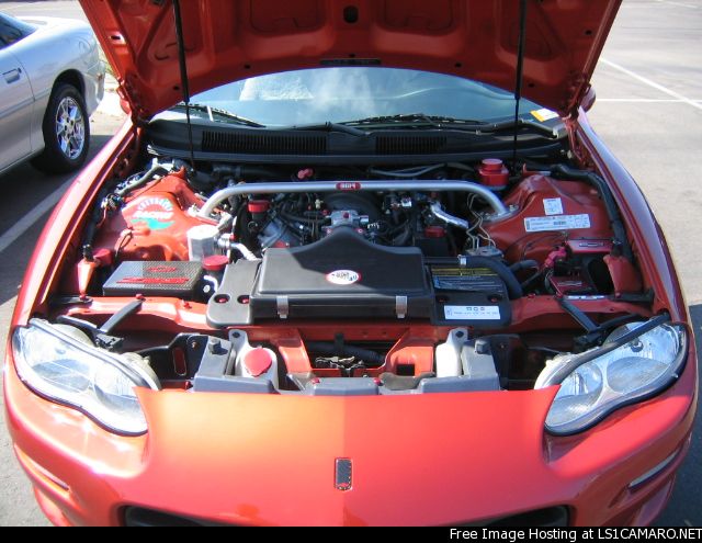

I know the 98-02 LS1 Gen III engines were notorious (sp) for using a quart of oil every 3-4k miles. I know these engines have dis similar metals in the piston bores the block being aluminum, the pistorn sleeve being steel. I do not know if this is the cause of the oil usage. In the case of my 01 Z28 (Sara) it is probably due to the aggressive style of driving that I employ :)
