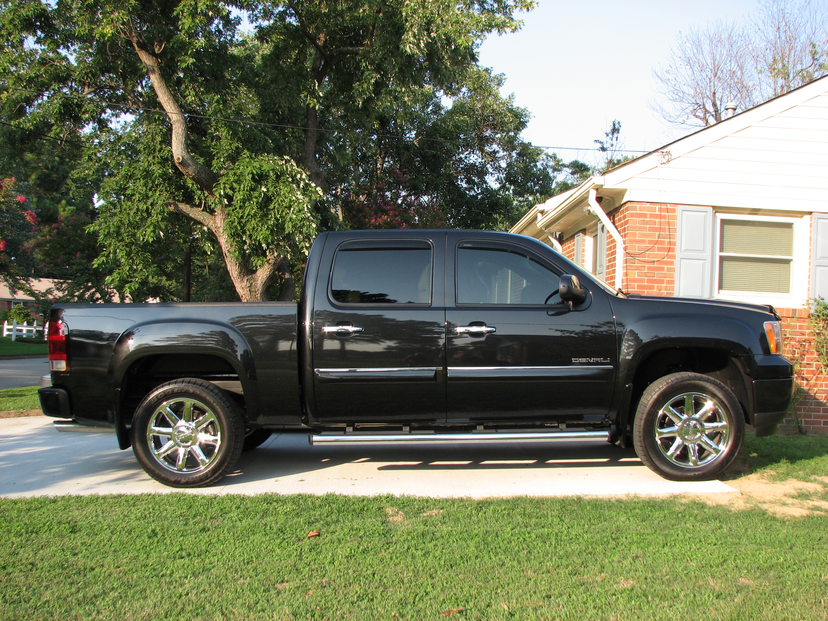

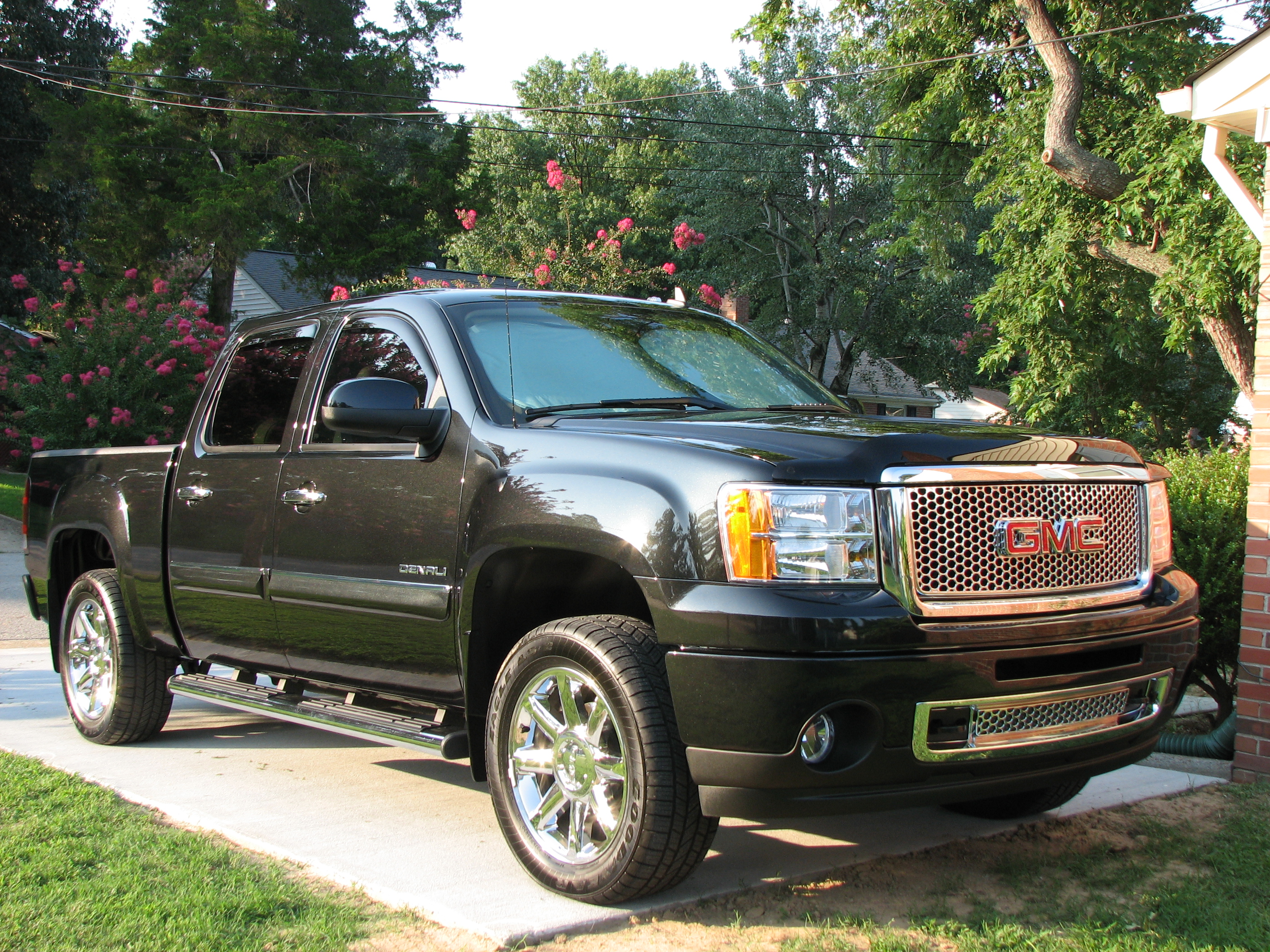

I tried to put the RC 2" leveling kit on mine. Got it re-aligned aftwerwards.
It drove prefect and it looked awesome perfectly leveled.
However, from 60MPH and above I had vibration in the sterring wheel.
The higher the speed, the worse the vibration became.
I took the kit off and re-aligned and as of today, I am still at stock hiegth.
Here is a picture with the RC 2" kit installed before I removed it.
