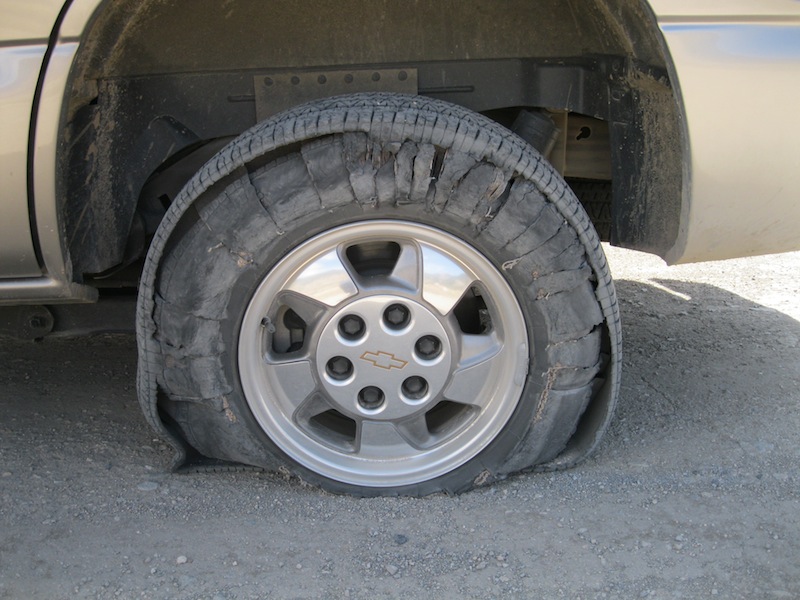

Weight is one thing, another is the extra "toughness" that a E rated tire gives you on rough, gravel, rocky roads. Those extra plys in both the tread and sidewalls can save your bacon.
C rated tire, 24,000 miles, gravel road, middle of know-where Wyoming.
Spare had 5 lbs of air in it.
Lesson learned, the hard way.
