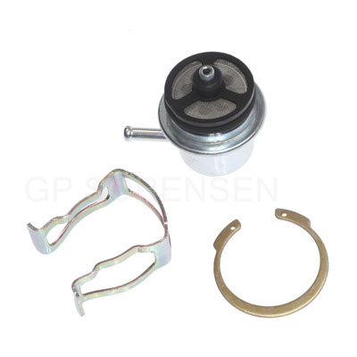

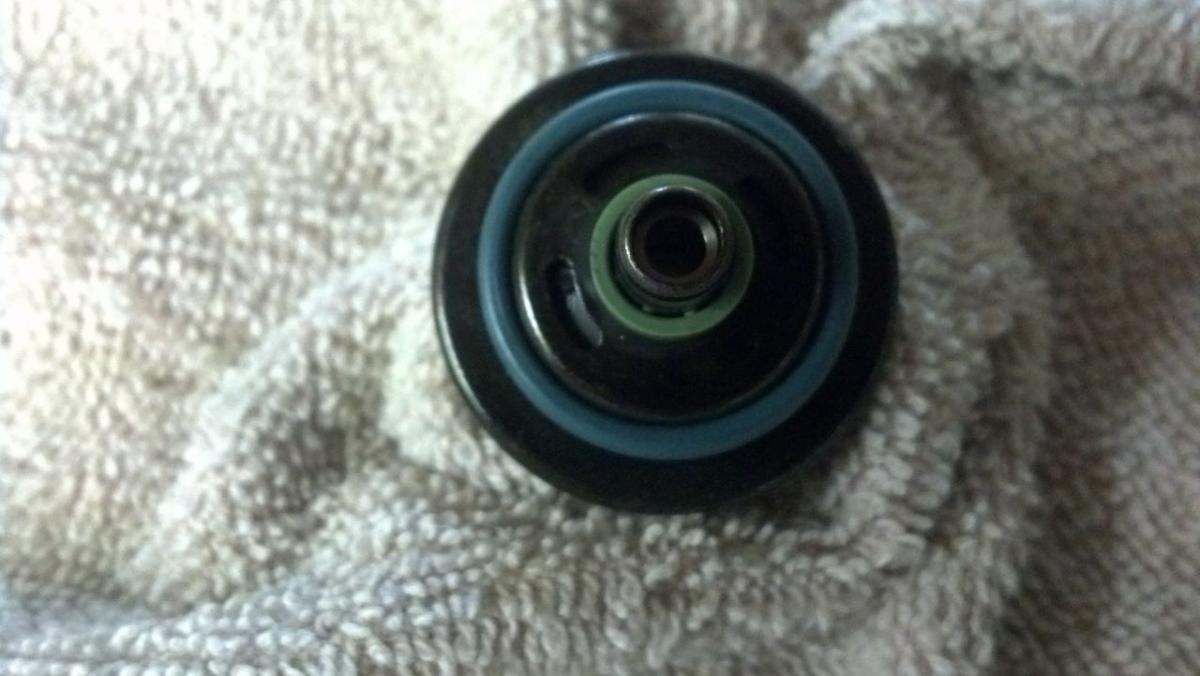

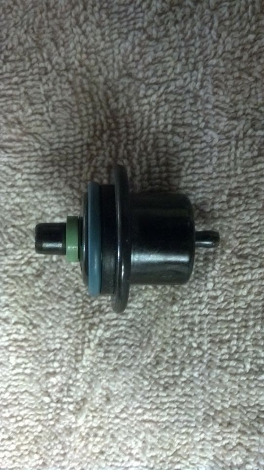

I need a little help in replacing the fuel pressure regulator. I purchased a replacement and while it looks similar to the OEM version, it's definitely different in style and fitment. The OEM version will 'snap' in place due to the rubber o-ring, then you install a bracket to keep the FPR in place. The replacement won't 'snap' into place and won't even stay in place before you go to the next step of installing the bracket. Also, the replacement came with a snap-ring but the OEM version didn't use/have one.
Anyone change theirs out and could help me figure things out?
Thank you, Richard
First picture is the replacement version with FPR, snap-ring and bracket.
Other pictures are of the OEM FPR from my Suburban.
Looks like you got the wrong part. You need this one.
http://www.autozone....omString=search
Two are available for the 5.3L; flex fuel and not a flex fuel. My ID has a 'T' and when you narrow the search to a 5.3L 'T', you get the part that I bought that doesn't look like an exact match of the original FPR. Choose the 'Z' / Flex Fuel version though and it looks exactly like mine... except I don't own a flex fuel version of the 5.3L. -
When I input all the vehicle parameters, I get: http://www.autozone....ier=221962_0_0_ which is what I bought, but sure doesn't seem to fit. I've gone to three other auto parts websites and come up with this exact part fitting my Suburban. All look the same, none match the looks of the OEM. Only one that does fits a 'Z' engine code.
Richard
Make sure you are removing ALL the parts from the old one. 3 different FPRs were used for your application, according to sources. Straight, angle and E85
Use the old one and match the parts. 3 different FPRs were used on your model year according to sources.
So should I buy the one that looks like my OEM but doesn't cross-reference at any online auto parts store? When I call, I'm told to buy the version that cross-references in spite of the fact it doesn't look the same... and NAPA guys are usually pretty accurate on the information.

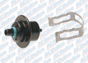

Your original definitely looks like the one designed for the "Z" engine to me. Check out AC Delco 2171582.

Hold up.....this one is for a "T" engine, AC Delco 17113700

By the way I located that part using my 2002 Silverado (Suburban also) w/ a "T" engine.....it does not show up under a 2003 Suburban though. I found it at www.rockauto.com and verified it on the AC Delco parts website.
Here are a few cross references for you.
AC Delco 17113700
Standard Motor Products PR359
NAPA Echlin CRB 219827
BWD 24067

Thanks bossier62guy;
That's the number that I was able to cross reference to the OEM part number. Went to Amazon and eBay; went with one on eBay for $44 with free shipping. Even though it looks like it's for a 2003 'Z' engine code and not a 'T', it looks exactly like mine. Can't say the same thing for every other 2003 'T' I was able to find. I suspect it comes down to my vehicle being built 06/03 and used the carryover FPR from the 2000-2002 model-year Suburban.
