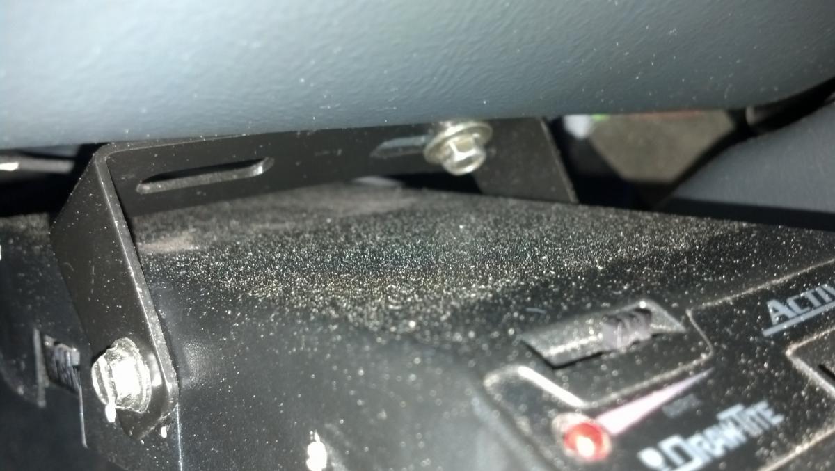

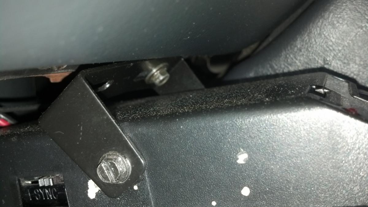

Not sure where your going to install your brake controller, but I installed my bracket on the bottom of my dash close to the center console, where the last bolt is. Just a suggestion. Here's a couple pics:
Not sure if the bracket is the same, but they should be pretty close
That's where it will be. Its just too damn hot today to install it. I did the wiring harness.
