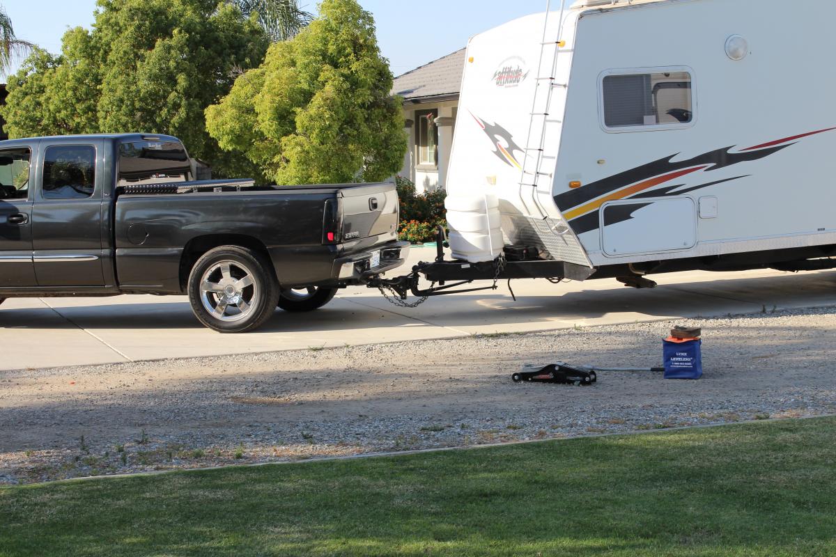

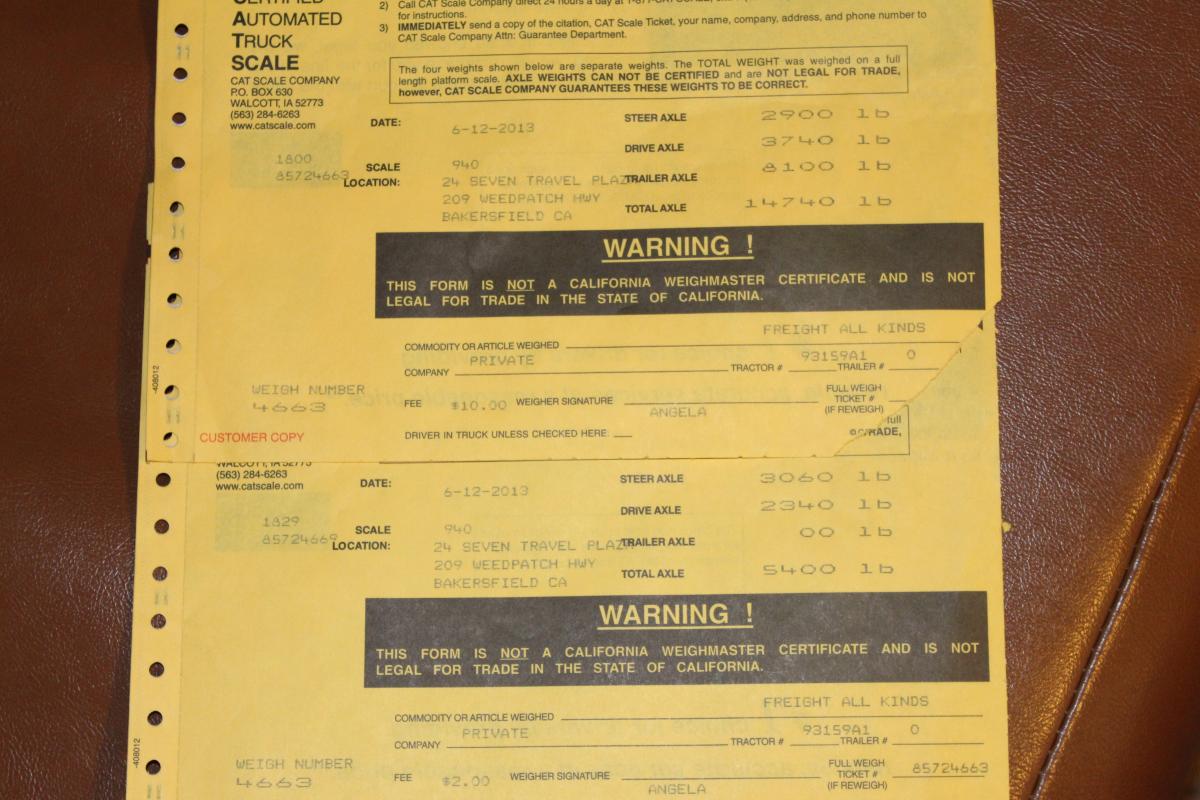

Here is what I will be towing. I towed it to the weigh station today to get numbers.
Top copy is with trailer. Not trip ready. Bottom copy is my truck with me in it.
I can't even see the numbers but I know campers can get pretty heavy, especially when you load everything you need. My suggestion would be to keep it out of OD
The only thing that I see that would worry me a little are what appear to be lower profile tires. I just returned from towing our camper to/from Florida, and some of the roads (especially in parts of AL) will absolutely beat the crap out of the tires/suspension when loaded heavy. I have 265/70-17, and I think that's about my minimum sidewall for towing, and I have them at 40 psi front / 44 psi rear (p-metric). That little bit said, your truck looks good!
Mine aren't p rated. They aren't LT either. Just between. I had 50 psi in them and they can take 65 I believe.
Sent from my DROID RAZR MAXX using Xparent Red Tapatalk 2
Now that I am out of bed, the tires are 275/55R20XL Cooper's. I keep 50 PSI in the back when I tow. the 2500HD springs helped a lot in that. the trailer is 9300 pounds not ready to camp
