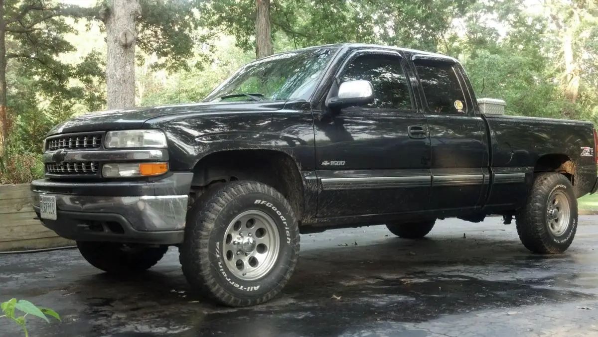

Here is a pic of my 02 when I had a Rough Country level on it:
LT285/75R16 All Terrains with 16x8 Mickey Thompson Classic II wheels
Your truck may ride a bit higher than this did because it had 280k when I put all that on, so everything was worn out from the tongue weight of the trailer (it towed a lot before). Even my torsion bars were worn out, they were actually twisted inward. So I replaced them with 2500HD bars. a little stiffer, but the front don't sag no more!
