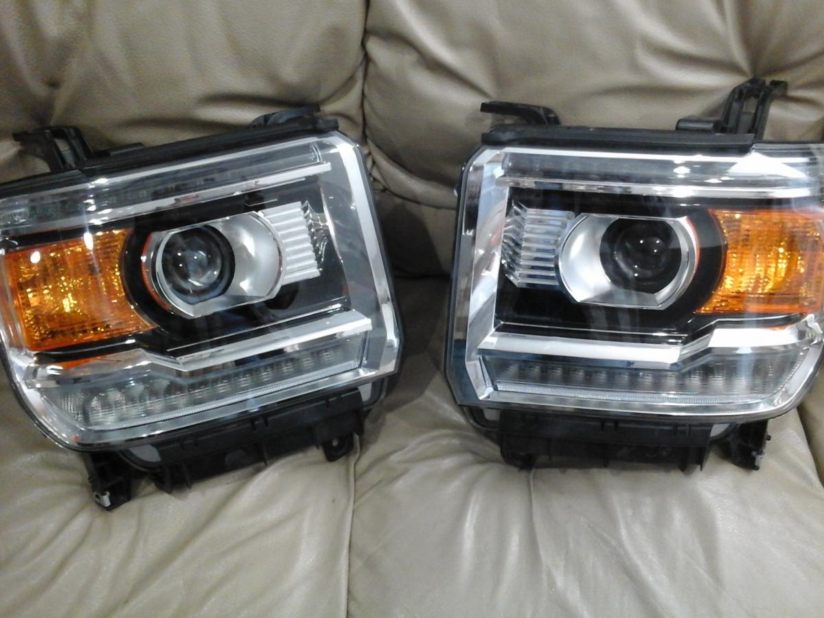

Hey guys and gals. So I bought a pair of slt headlights for my sle, bought them for 200$. Got them home and pluged them into my light harness, they work the same way my sle ones do but with no leds at all. I still get low and high beams and the orange runner's but no leds at all. From what I am seeing the black and red wire are running the low and hi beam.green yellow and black are running into there own seperate area behind the orange marker light. Witch leaves a blue white and brown wire that I think is powering the leds.also when I take the housing out that covers the light bulb for replacement, there is a black orange red and grey wires that look like they are going to the top leds witch doesn't make sence to me. I dont mind being the ginne pig since it only cost me a 100$ a light. Thanks guys!
Unfortunately the internal wiring of the SLT headlights is much more complex than it appears. There's 4 to 6 wires going to each of the LED strip boards.
Unfortunately the internal wiring of the SLT headlights is much more complex than it appears. There's 4 to 6 wires going to each of the LED strip boards.post-34923-0-04418200-1396052583.jpg
