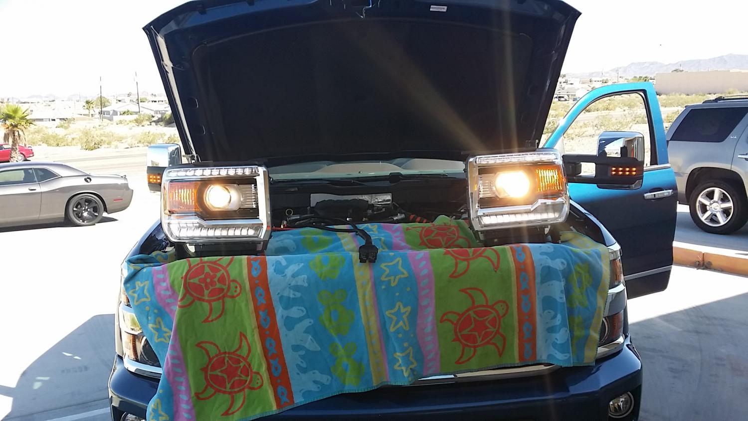

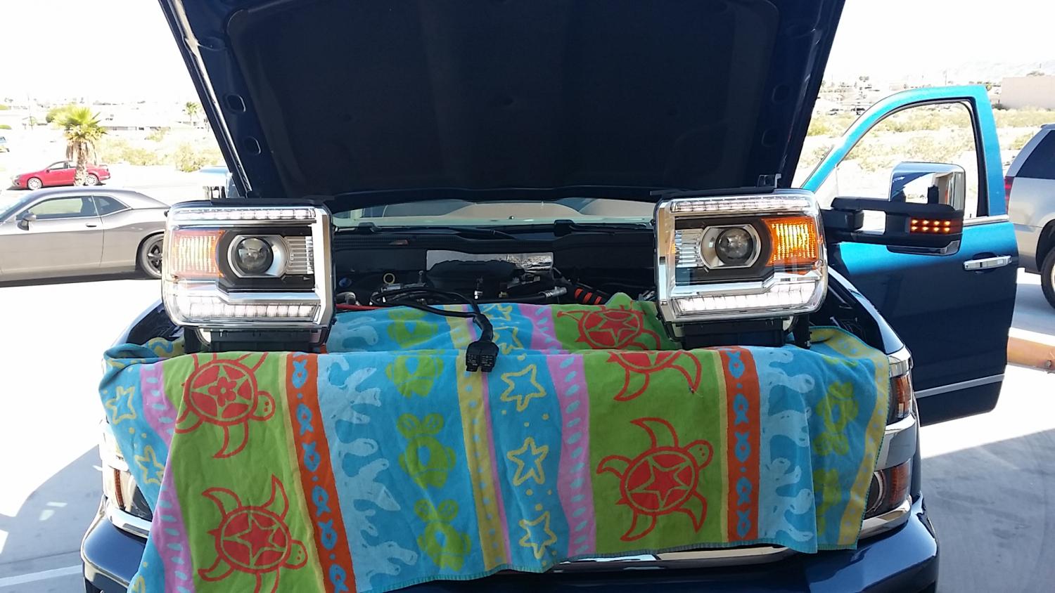

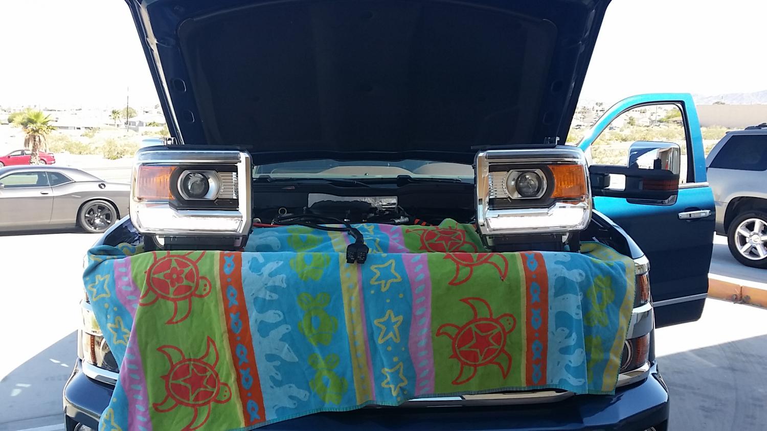

So we tested it today, it all works like we said it will, no need for load rissisters, its 100% Plug and play, here is how it works, start your truck no lights on at all, put it in to gear, lower LED comes on at full power, you drive like this all day long, at night the side makers come on with the headlight in low beam, and so do the 2 LED bars in low power, flash or turn on the hight beams the LED's stay on and your high beam is on too.
In day time if you turn on the side markers the LED come on in low beam, and at any time you can use your High beams to flash a car.
Last your BCM will never know what we did it will think this is normal.
