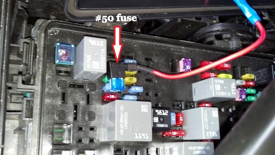

Hey guys. I'm the one who did the harness test today on my '14 Sierra SLE crew. The harness works great so far. Here's the overview. NOTE: I had my BCM flashed last month as per service bulletin PIT5374A to increase headlight voltage from 12v to 14v.
* Engine running in daylight, bottom LED's full power no headlights for DRL anymore.
* With headlights on, top and bottom LED's low power.
* All features work fine with switch in auto or manual.
* Another cool feature is that when you lock or unlock the doors the top and bottom LED's come on low power with the park lights just as they do now.
I didn't have the flickering issue like some of you but had a few other issues and now seems to be fine. This harness will have one extra relay and a 12v and a micro mini fuse tap that you will need to install. The fuse tap will go to fuse #50 15 amp O2 sensor. I drilled a small hole on the side of the fuse box cover and covered the red wire on the outside of the fuse box cover with small wire loom (pics attached). Thanks Ofer and Jared for figuring it out. These guys have countless technical hours in this.
