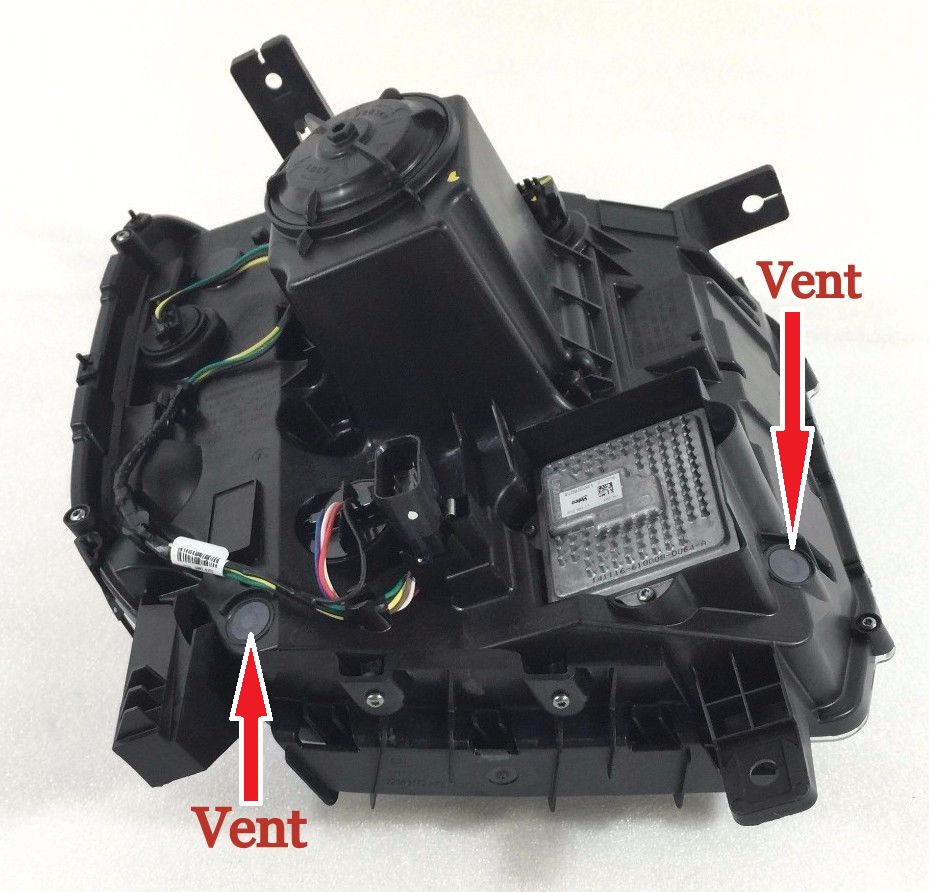

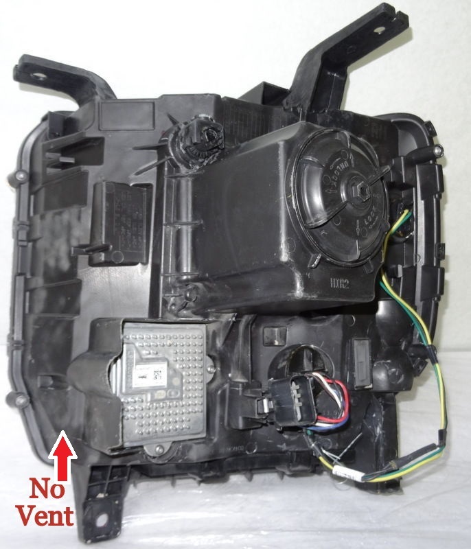

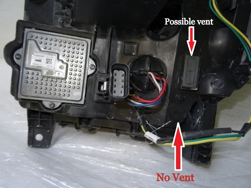

I hear ya man lol. There was a design change in the SLT lights on the LED's and a change in the venting system because of headlight moisture and condensation but not sure exactly when the transition date was. I did some research and compared pics before I purchased my lights to be sure I got the newer Gore venting system and at least a late 2014 or newer build date to be sure I had the whiter LED's. Like I said, not sure when the transition was and my build date was Jan 2015. Here is a diagram I just did to show the difference in venting system between the older and newer lights.

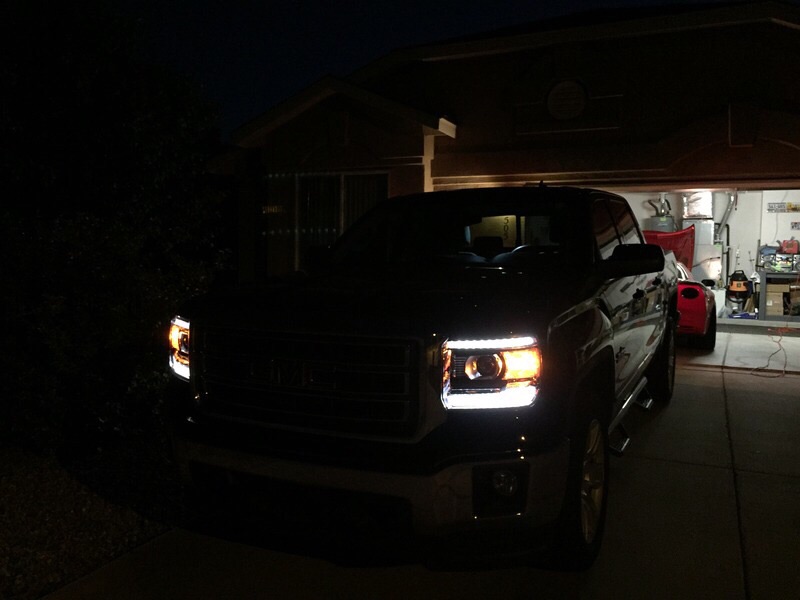

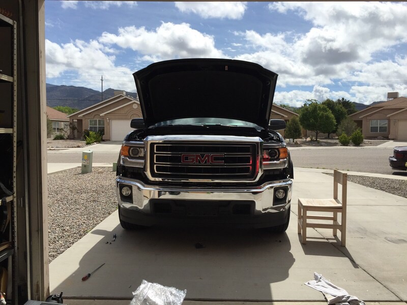

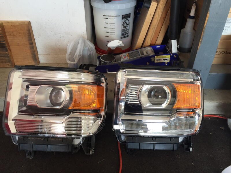

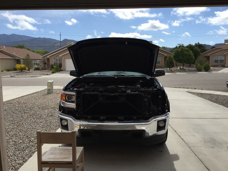

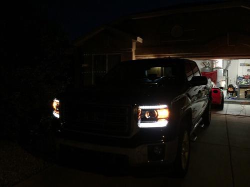

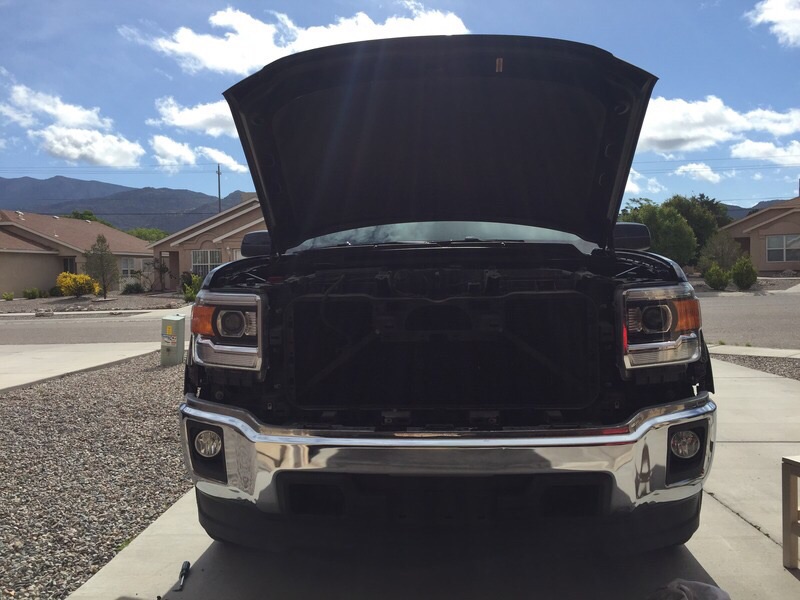

Well finally received my headlights and harness thurs night. So Friday morning when I got off I decided to install everything. Took me a little over an hour to take my truck apart and put it back together. I'm very pleased with the outcome of the lights and harness

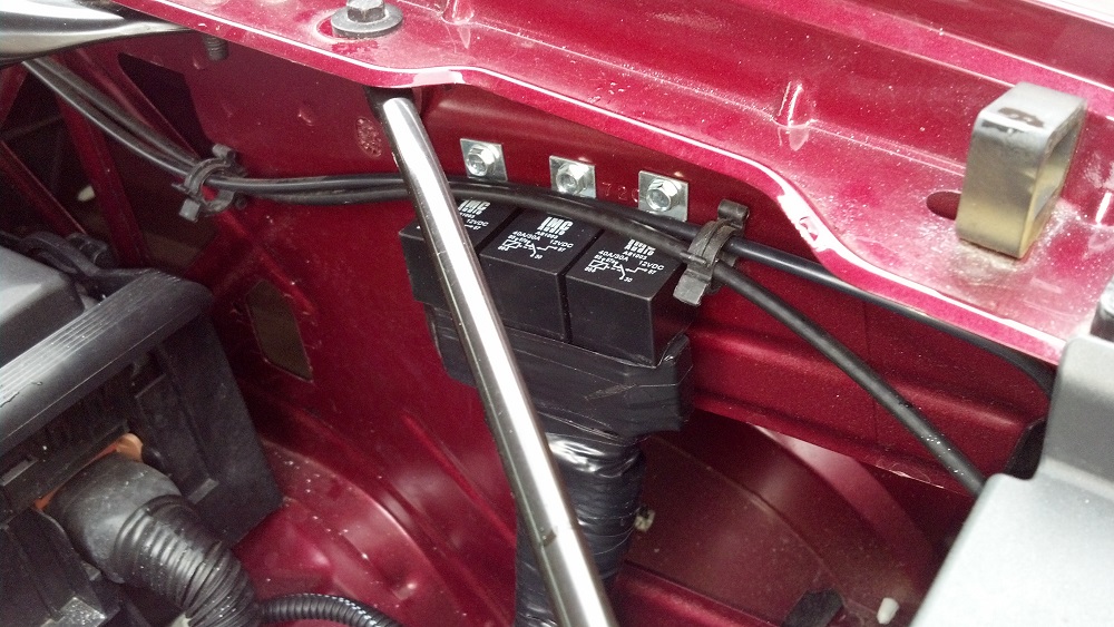

Here's where I mounted my relays. Used self tapping screws and easily accessible if a relay needs to be changed.
