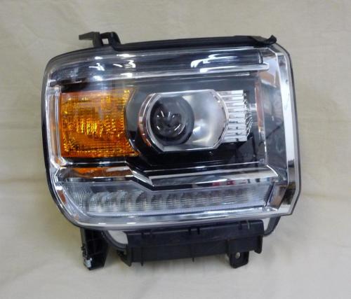

Wonder if this Gen5DIY harness will work with the 2016 headlamps? All new GMC Sierra's come with HID's and LED DRL as standard.
Looking to make my 2014 GMC Sierra SLE work with the 2016 headlamps. Looks like they are the exaxt same form factor as the current models. My thinking is they will bolt right in.

I'm almost sure they will bolt on. If there is a difference in the harness I'm sure Jared and Ofer will figure it out. I like my '15 SLT LED lights. Not saying I won't entertain the option of the '16 lights if they work.

I have an extra new take off set of headlights from a 2015 Denali with the harness as well to use on the SLE. PM me if interested.

Came here to post this. Friend just picked up a 16 and I've already been all over it looking at the lights. The brackets all look the same from what I can tell. The harness is different but should be easily modified. If I knew I could make it work I would sell my SLT lights and buy them to see. I fear I'd sell mine then be out $1700 and no headlights. I have the part #'s if anyone is willing.
The Sierra uses the new round plug now which is the standard plug across the GM fleet now. With the turns being LED, there would need to be a load resistor for the '14/'15 BCM and to prevent hyper flashing. I have the part #'s as well.
The resistor mod that works for the switchbacks could work.
Yea it would have to be an inline resistor. We didn't use them of our switchback headlights. We tied the LED switchbacks into the yellow turn signal wire so it uses resistance from the OEM incandescent bulb to prevent hyper flash..
