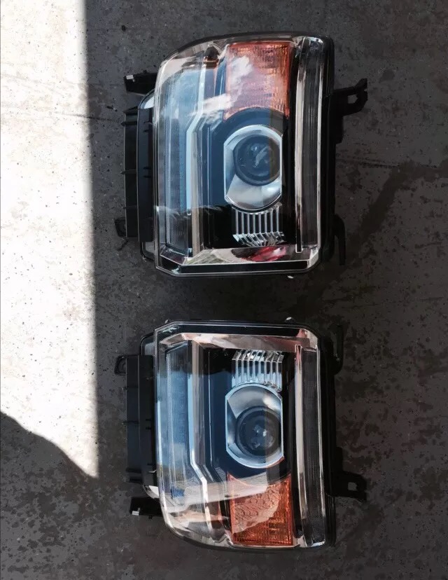

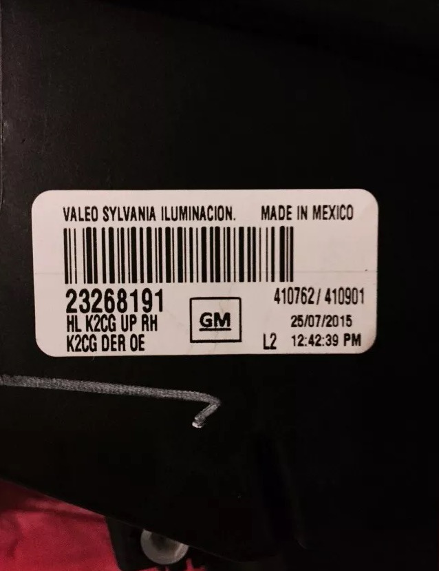

So I bought a pair of headlights off a 2015 Denali manufacturing date 7/25/2015 but the part numbers are #23268190 for left and #23268191. Does anyone know what the difference in these headlights are before I take everything apart and buy the hardness???? The number doesn't even come up as a part number anywhere I looked ...help!!??
The part numbers should be 23130715 and 23130716. Not sure of those numbers as SLT and Denali headlights are the same. Never heard of those part numbers. Post some pics.
You must mean mfg. date of 7/25/15 and not 16.
Yes that's correct with the part numbers jays why I am asking the question .... I looked these numbers up and they show to be non existent where I looked so I was wondering if they changed part number in the newer manufactured headlight. Can't post pics from mobile sorry...
Any help would be appreciated , LEDs are there and they seem to fit as well.
Why can't you post pic from mobile? How did you upload your avatar? Do you have a pc that you can use? GM changed a few things in 2014 but the part numbers stayed the same. Wish I could help you bud..
post-128733-0-62786600-1443145870_thumb.jpgpost-128733-0-25846100-1443145907_thumb.jpg
