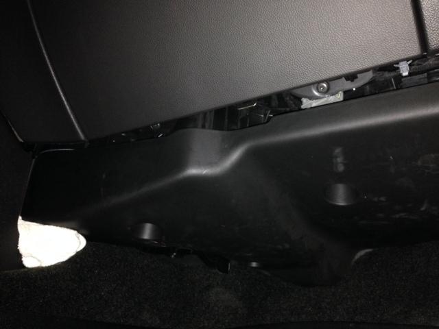

Here is my culprit:
See the photo. This is the plastic shroud or compartment below the glove box area on the passenger side of the dashboard. Notice my "joe-job" of the sock to temporarily create enough lift and pressure to stop the rattling noise during driving. Notice the area is suspended/affixed by 2 rivets. The sound is replaceable by simply tapping ones fingers on the shroud area and sounds like a rattling or jingling. The sock helps, but I head to Chevy tomorrow.
Hope this helps you-

After about a day at the dealer, they said they added "additional insulation" inside this area and as such the rattling went away. This is great news!

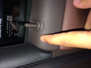

I have a faint rattling noise coming from the driver window area in my 2014 silverado high country, its driving le nuts to say the least and im hoping i can get some advice on what to do here.
I already took it to the dealer but the guy said they fixed it and then as soon as i drove out the dealer, there it was. So its getting really frustrating.
Its seems like its coming from the top of the door panel (where my finger points to in the picture). When i press on it or when I push the window outwards being fully closed, it stops.

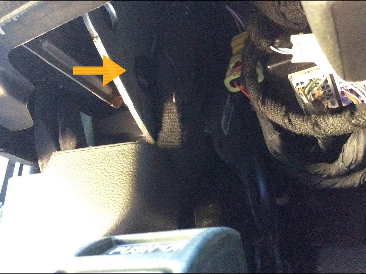

Think I found mine. There is a cable bundle routed behind the dash panel down near the parking brake pedal that has a plastic "guide" to hold the shape of the bundle where it is routed. There is a push fastener on the plastic piece that looks like it is supposed to attach to the frame.
Here is a picture:
It had become unattached and was dangling so going over rough spots in the road it would tap against the frame that it was supposed to be attached to. Hopefully reattaching fixes it or if it comes loose again, zip tie.
Update:
Well that wasn't it BUT I did look into the hood release cable suggested above and low and behold that looks like it may have been the culprit.
There was quite a lot of play so I found some place to temporarily attach the cable to take some of the play out and the rattle was reduced significantly. There is still a little there so I am thinking now there is some play in the cable back behind the dash as well that I just can't get to. Have an appt with the dealer next week so we'll see what they can come up with.
