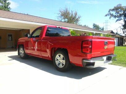

Here are some pictures from a truck here in Houston that has a 4"/6" on a RCSB Silvy. Imagine if he had gone 2" more in the back that should give you a idea of what a 4" difference will be.
