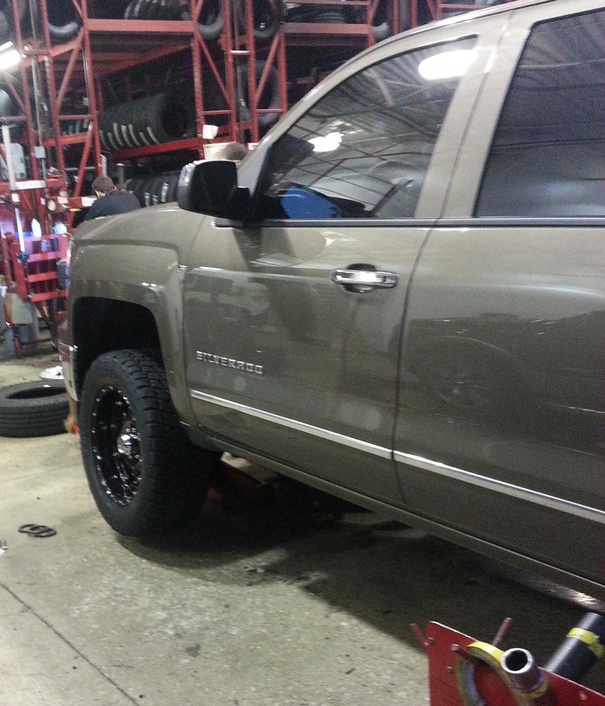

Here is a picture of it when fitting the wheels
Awesome wheels. Is that gloss black with chrome? Good match up with your truck color too.
