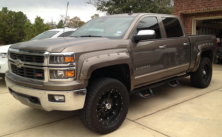

As far as flares go its going to depend what brand you go with for it to look right. I would bump it up and do the combo with 1.5" body lift that I did.
Here is a picture as it sits today
Hey thanks, but I do not want to put a body lift as it would cost must as much to put a 4 3/4 left pretty well couple hundred bucks more,
I just don't see flares looking right with a +18 wheel on there and a -12 wont fit unless you go taller
Will the +18 be sticking out at all? I can get like custom fender flares like with 1 inch thickness
