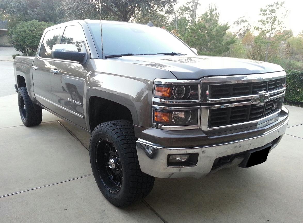

After the 2.5" suspension & 1.2" body lift:

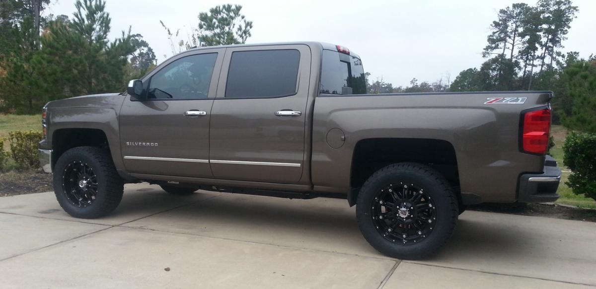

After 4 inches of lift with wheels & tires (305/55r20; -12 offset). Overall a true 6" of lift:
I'm not rubbing at all while driving forward and I got a slight rub while in reverse but its not enought to even worry about. I test fit the Bushwacker fender flares and they fit up just fine without rub. I'll be getting them painted and hopefully get them on in the next two weeks.
I would not recomend the -12 offset to anyone unless your going to do fender flares; they do stick out quite a bit and depending on the driving you do they would cause some debris thrown up on the paint.

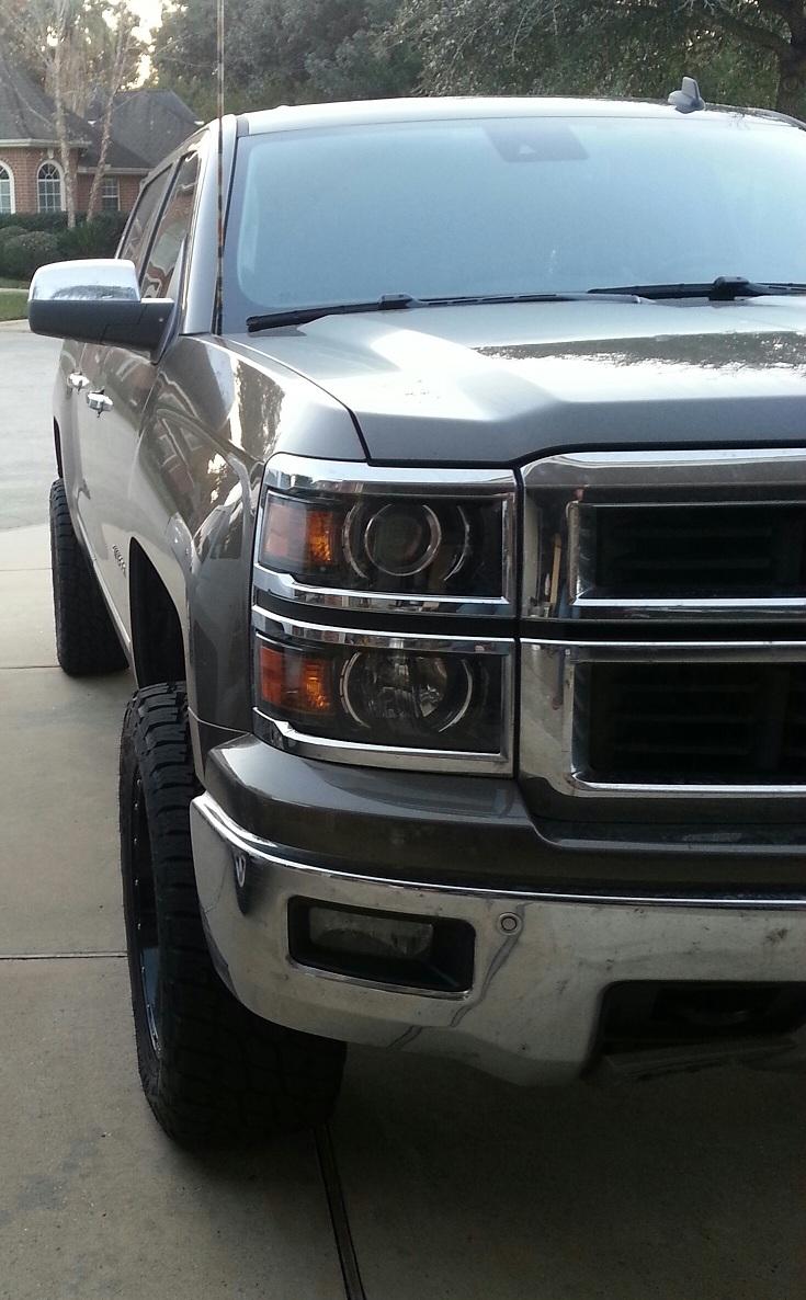

Can you take a picture of how much your tires stick out? I have -12 wheels too and would like to see how far they stick out. Thanks.
I'll try to have some pictures posted by tomorrow. I'm also going to snap a few next to a stock 2014

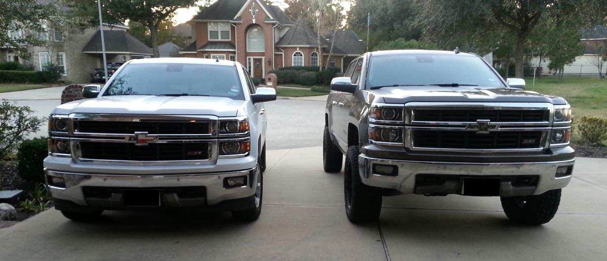

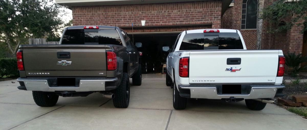

Ok as requested I got a few more pictures for everyone. I was also able to take a couple next to my dads stock 2014 (exact same truck, exact same options when purchased).
I didn't realize it until I looked at the pictures but my front wheels weren't perfectly aligned. Tried to get the best angles possible for everyone.

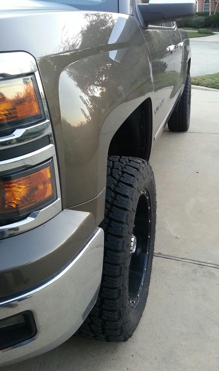

No if you look close at the picture I hit some road debris; you can see that front plastic piece is sticking out to the left of the license plate. After ordering them 3 different times I finally have all the correct pieces to fix it next week. I didn't buy the lower though because I like the way it looks without it.
Actually, the same thing my tire guy told me. I was looking at the Toyo A/T but maybe going with the 305/55-20 instead. Its a really good looking setup on your truck. The guy at the shop recommended a -12 offset to get more "lip" on the wheel. Do you think I have enough lift to clear?
It will add more lip for sure but +18 might give you the look also. With a +18 you definitely wont rub. -12 will be close but I think it may work, your only 1/2" shorter than me. If that's what he recommends I would go with it and if it doesn't just have them order in some +18; any reputable shouldn't have a problem doing that for you. If you test them out drive it in reverse, I'm getting a slight rub only when I turn the steering wheel right in reverse, I haven't been able to figure out the exact location yet but like I said its just very slight.
Again don't forget the -12 offset will cause debris to be thrown on the side of your truck. Look at the back passenger side behind the tire. I started developing a build up this week that I never had before. Fender flares will cover this but I wouldn't risk the -12 unless you like the look of flares.
