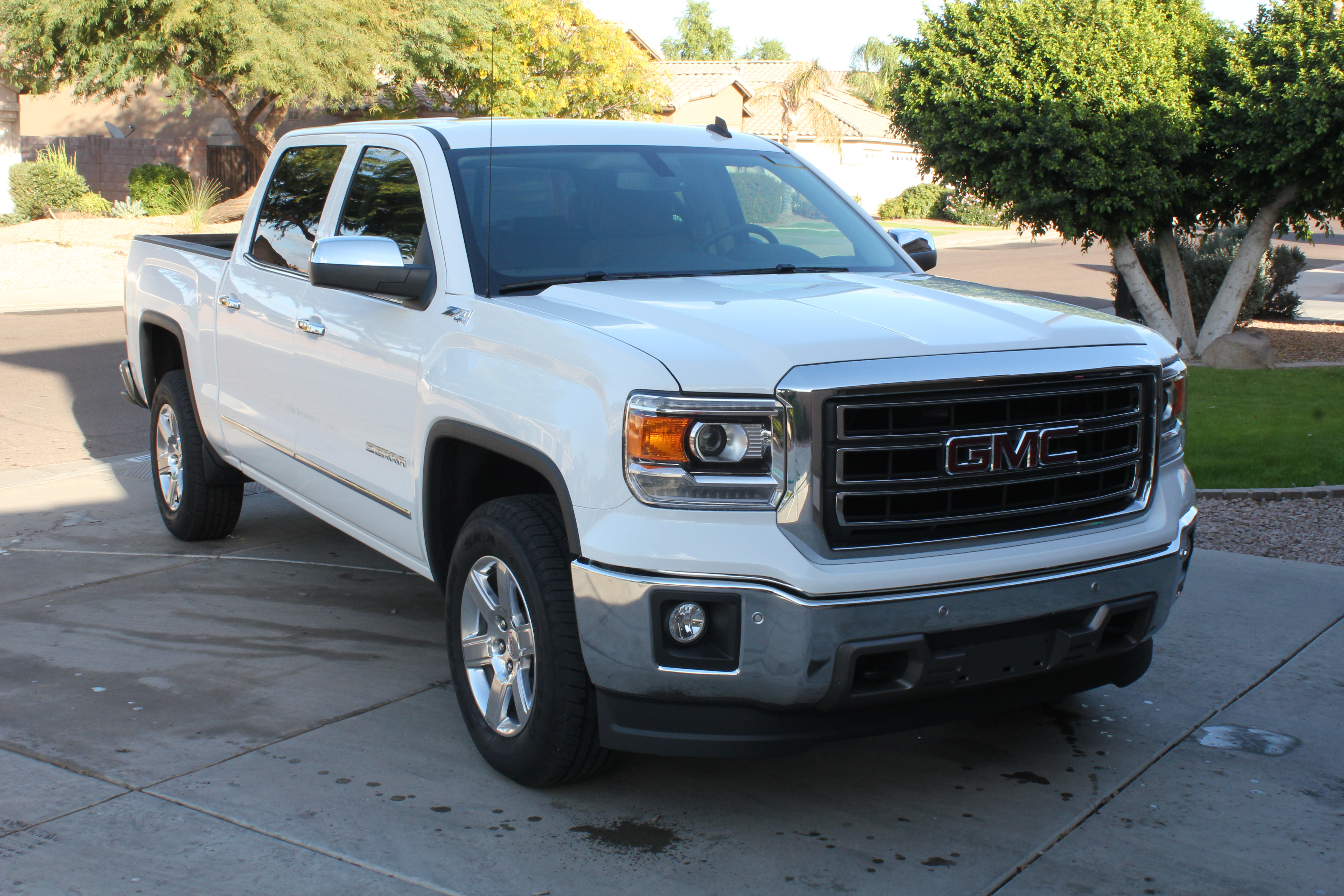

Im currently trying to decide which route I am going with wheels, tires and leveling kit. I like the stance of your truck from the front. Do you by any chance have a side view of your truck you can put on here? Thanks
My aftermarket wheels are 20x9 +18 and I run 305/55/20 Nitto Terra Grapplers with the RC 2". I have a very slight rub that I hope to fix this weekend by "pulling" the wheelhouse liner half an inch at just the right spot (still figuring out how to secure it there -- I might gorilla tape a washer to the backside of the liner and then run a zip tie through the washer and to nearby frame/body/whatever pulls the right direction).
Based on the fitment on my setup, I'm guessing you could do a zero offset wheel and this same tire size. Even then the outer edge of the tires still might not line up with your fender flares, though. The tires would stick out 2/3 of an inch more than mine. Seen here: (Warning, my front wheels were turned a little in this picture. Look at the back wheel.)
IMG_5518.JPG?dl=1&token_hash=AAH2KCdOB2N
If you stay narrow (like 65+ series) you can run 34" tires with just the RC 2" on stock-offset wheels (25+). I think one or two on this forum have reported _no_ rubbing with that setup. But you can't have that and still get the tire line to reach the aftermarket fender flares.
Thanks!
Before:
IMG_5492.JPG?dl=1&token_hash=AAGT3RNh4k6
And After:
IMG_5516.JPG?dl=1&token_hash=AAF2OMYRtf-
And here:
IMG_5521.JPG?dl=1&token_hash=AAFdbjUTk3h
I really need some new pictures because as you can see the fluorescent red doesn't really work, so I put the chrome inserts on right away but I'm still doing a few more mods and will get more pictures eventually.
Anyway I hope this helps you somehow. Getting just the right stance is tricky.
