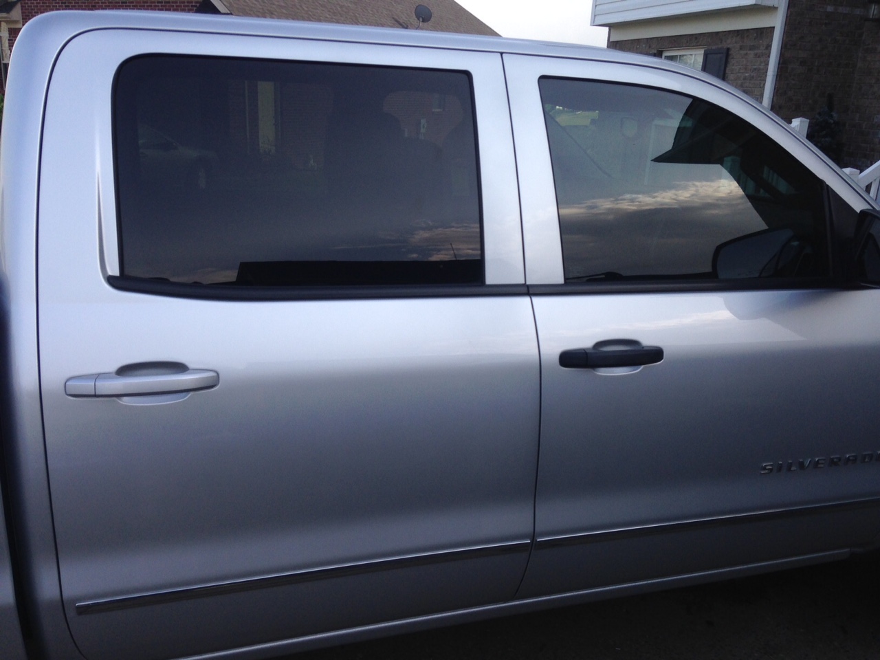

This post was extremely helpful. After reading everyone's post and watching one YouTube video, I replaced all 4 of my handles in 15 minutes. EASY!!!! If you're considering...do it! c09cbbe87e8c0c161b259be783d4917f.jpg
