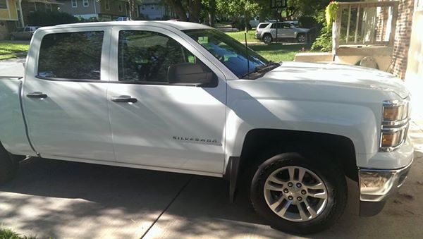

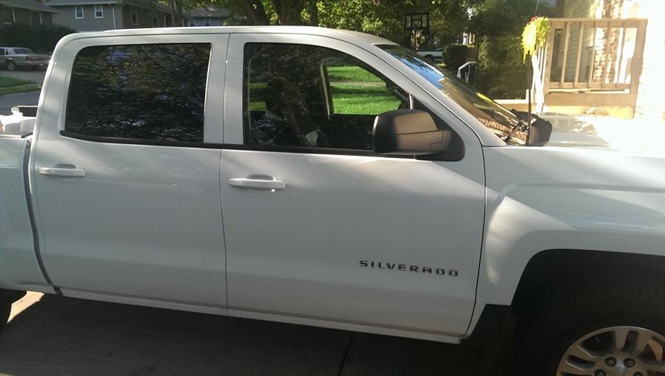

Just got my Summit White handles installed in about 15 minutes total (before and after pics attached). Got mine on eBay for $235, with white mirror caps that I haven't installed yet. I haven't found a thread that tells how to remove them w/o breaking something.
You guys had me really worried about the screw falling out, or it would have been a 10 minute piece of cake! The first one, I unscrewed it several turns and thought it was wobbly enough that I should stop. Well, it wasn't enough, because the back piece of the handle wouldn't come off with prying, pulling, etc. It finally snapped off and I realized another turn or 2 on the screw would have allowed the piece to just fall out basically. And there was PLENTY of thread still left inside the door. Once I realized that, the others were a breeze.
Oh, and the other part about using something to pull the "E" piece out toward you. I ran in to get fishing line from an old tackle box. Must have been too brittle because it broke without getting to pull the E very far. So my only other option was some frayed twine. I also pinched a little to keep it narrow enough to fit through the opening. Then I found it best to loop it around the bottom of the E, because with it in the middle, the handle wouldn't fully seat inside it. This was all figured out in about 5-10 min on the first one, and the others were literally about 1 minute each. I almost had my wife video the last one to put on here, but I think the first video and everyone's tips were more than enough.
If you're on the fence, just do this! I'm as worried as anyone about messing with stuff and not getting it back together perfectly. This was a breeze and they look/function perfectly.
